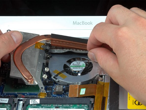

  • Carefully peel up the black felt tape between the heat sink and fan.

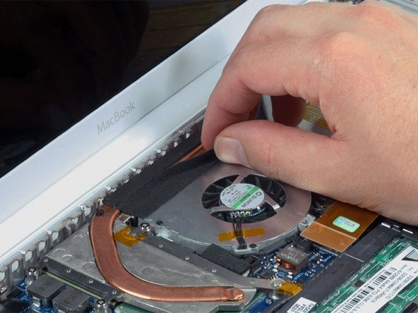

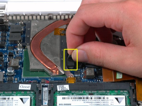

  • Peel up the small black rubber cover from the right side of the heat sink.

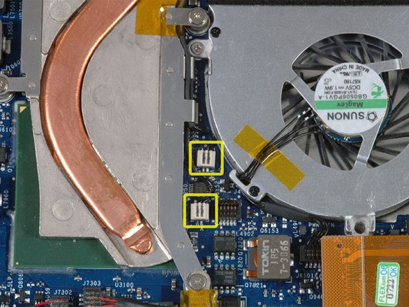

  • Disconnect the two newly-revealed temperature sensor connectors from the logic board.

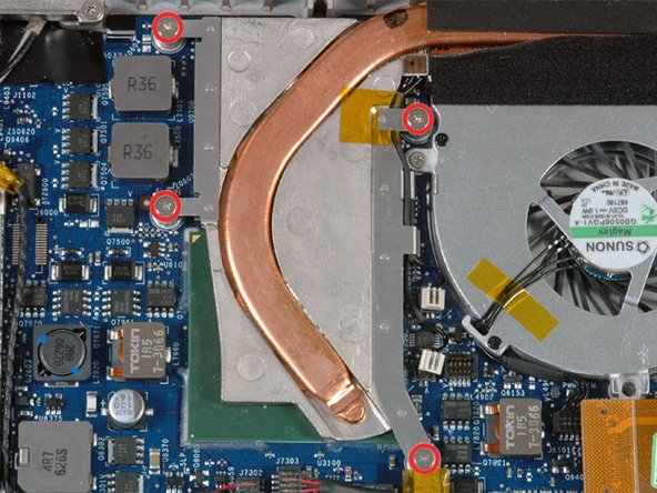

  • Remove the four Phillips screws securing the heat sink to the lower case.
  • Be sure to secure ground loop for the speaker cable beneath the screw in the lower right corner.
