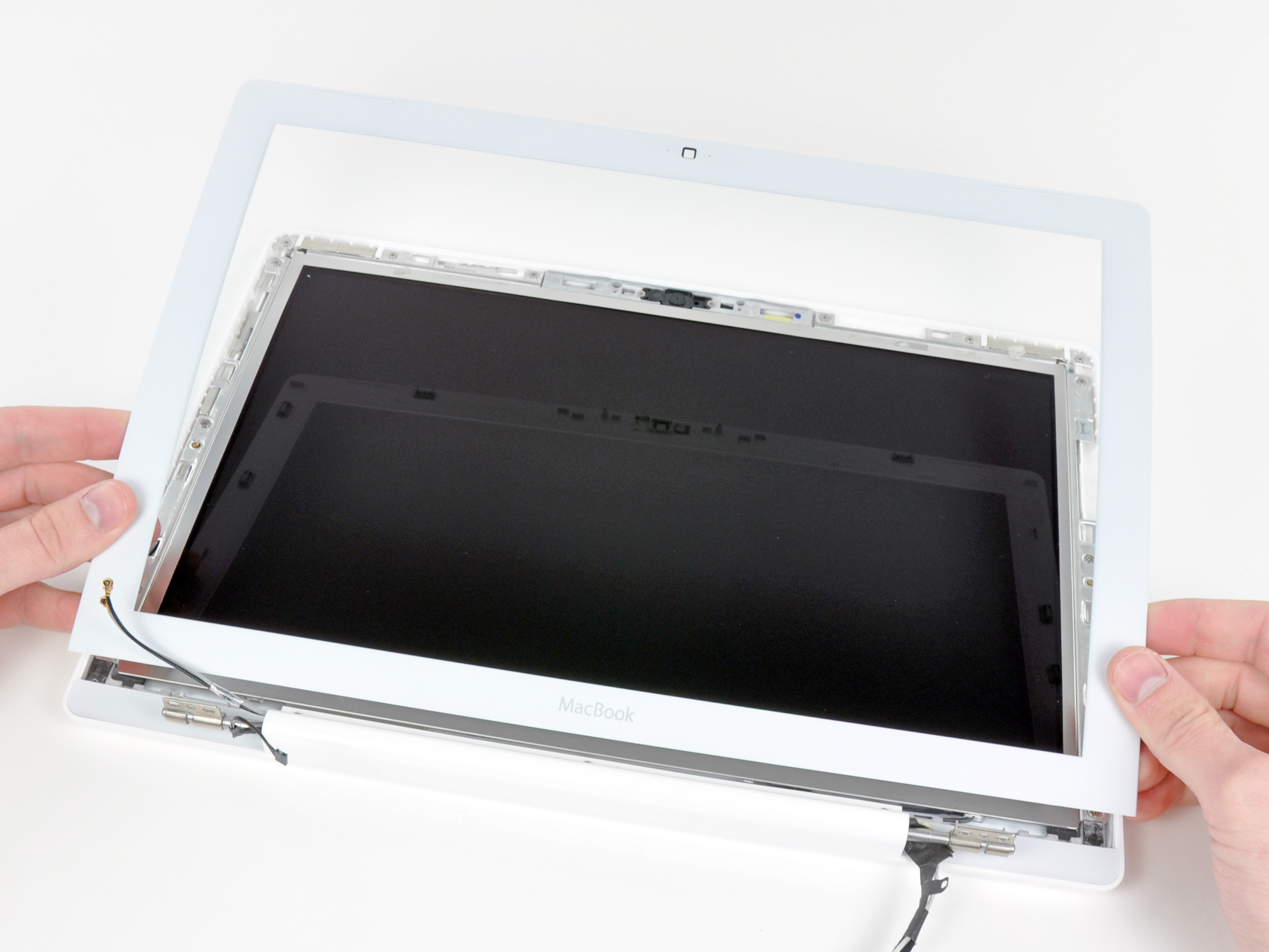

Use this guide to replace the plastic frame around your MacBook Core Duo's LCD.
Image #1
  • Use a coin to rotate the battery-locking screw 90 degrees clockwise.
Image #1
Add Note Edit Step 2  ¶
Image #1
Add Note Edit Step 3 — Memory Cover  ¶
  • Remove the three evenly-spaced Phillips screws from along the rear wall of the battery compartment.
  • The screws are captive to the metal memory cover.
Image #1
Add Note Edit Step 4  ¶
  • Lift up on L-shaped memory cover, slide it to the right, and lift it out of the computer.
Image #1
Add Note Edit Step 5 — Upper Case  ¶
  • Remove the following 3 screws:
    • One 11 mm Phillips #00 in the middle of the case.
    • Two 14.5 mm Phillips #00.
  • If the screws stick in the case, you can use a magnetized screwdriver to draw them out.
  • The shorter of the three screws goes in the middle.
Image #1
Add Note Edit Step 6  ¶
  • Remove the following 3 screws from the rear wall of the battery compartment:
    • Two 3 mm Phillips #00.
    • One 4 mm Phillips #00 on the right side.
  • When reinstalling these screws, press gently on the lower case to line up the screw holes.
Image #1
Add Note Edit Step 7  ¶
  • Remove the two 6 mm Phillips #00 screws from either side of the right wall of the battery compartment (not the ones closest to the battery connector).
Image #1
Add Note Edit Step 8  ¶
  • Remove the four 3 mm indicated Phillips #00 screws from the front wall of the battery compartment. When working from the left, remove the 2nd, 4th, 7th and 9th screw.
