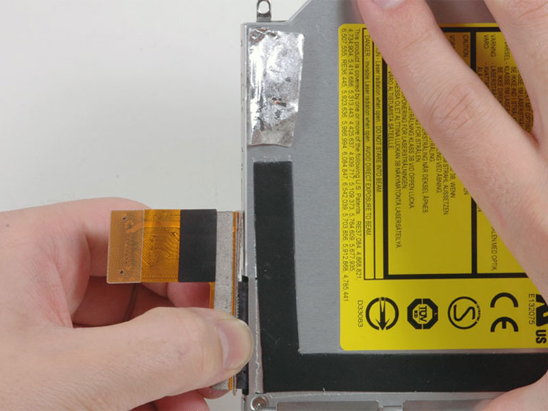

  • Use a coin to rotate the battery-locking screw 90 degrees clockwise.
Image #1
Add Note Edit Step 2  ¶
Image #1
Add Note Edit Step 3 — Memory Cover  ¶
  • Unscrew the three evenly-spaced Phillips screws from along the rear wall of the battery compartment.
  • The screws are captive to the metal memory cover so you cannot lose them.
Image #1
Add Note Edit Step 4  ¶
  • Rotate the L-shaped memory cover so it clears the battery compartment opening and lift it up and out of the computer.
Image #1
Add Note Edit Step 5 — Upper Case  ¶
  • Remove the following 3 screws:
    • One 11 mm Phillips#00 in the middle of the case. (Head: 5mm dia. x .75mm thick)
    • Two 14.5 mm Phillips #00 (Head: 5mm dia. x .75mm thick)
  • If the screws stick in the case, you can use a magnetized screwdriver to draw them out.
  • The shorter of the three screws goes in the middle.
Image #1
Add Note Edit Step 6  ¶
  • Remove the following 3 screws from the rear wall of the battery compartment:
    • One 3 mm Phillips #0. (Head: 2.75 mm. dia.)
    • Two 4 mm Phillips #0 on the either side. (Head: 2.75mm dia.)
  • Take extra caution with these screws as they can strip easily.
Image #1
Add Note Edit Step 7  ¶
  • Remove the two Phillips screws from either side of the right wall of the battery compartment (not the ones closest to the battery connector).
    • Two 6.25 mm Phillips #000. (Head: 4 mm. dia. x .5mm thick)
Image #1
Add Note Edit Step 8  ¶
  • Remove the four indicated Phillips screws from the front wall of the battery compartment. When working from the left, remove the 2nd, 4th, 7th and 9th screw.
    • Four 3.25 mm Phillips #000. (Head: 4 mm. dia. x 4mm thick)
