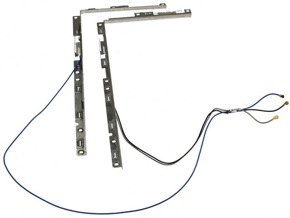

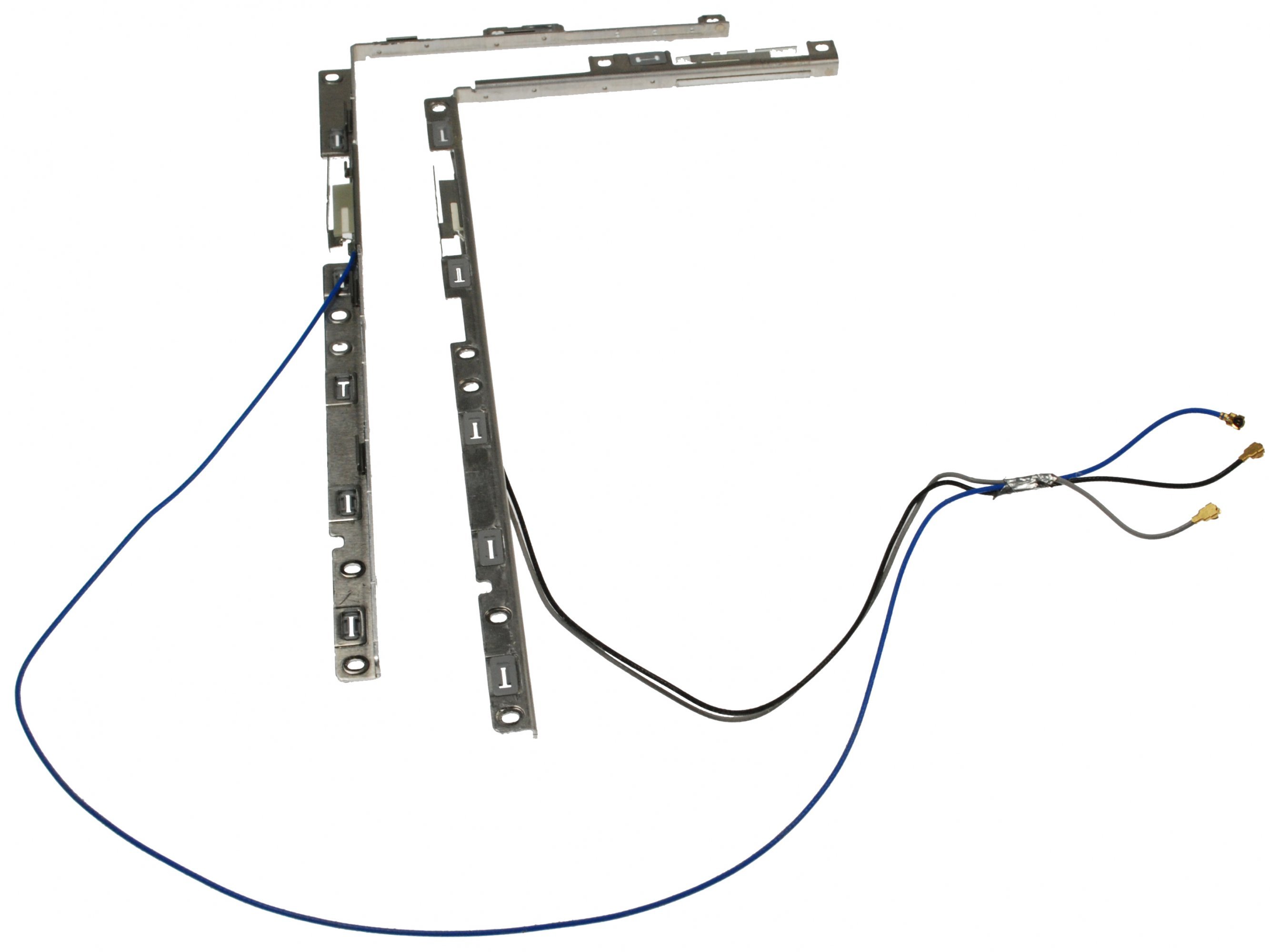

Add Note Edit Step 61  ¶
  • Lift up the LCD panel by its bottom edge and slide it out of the metal mounting brackets.
Image #1
Add Note Edit Step 62 — LCD Mounts  ¶
  • Remove the iSight mount from the LCD mounts.
  • LCD mounts remain.
