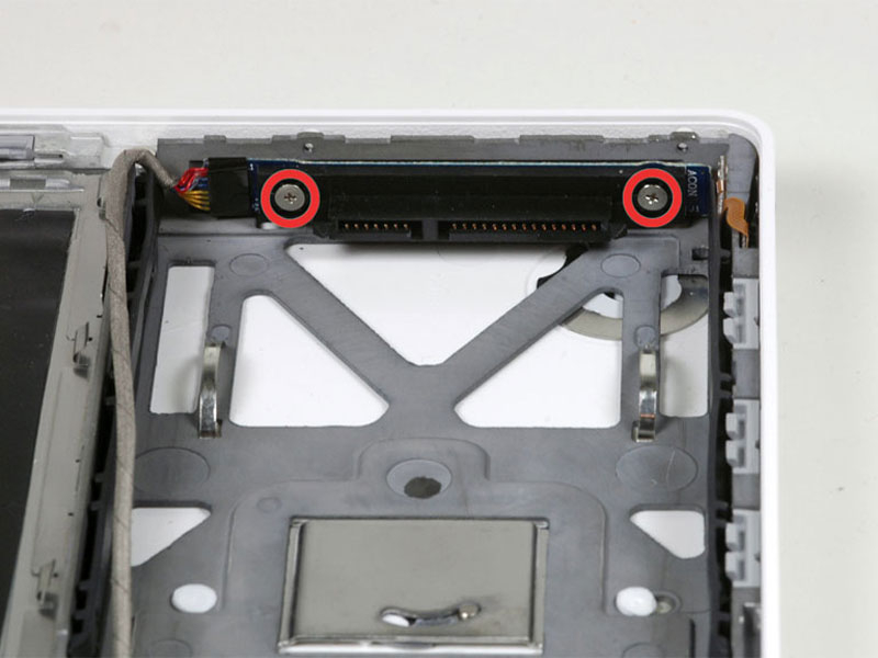

  13. MacBook Core 2 Duo Hard Drive Connector Replacement, Hard Drive Connector: step 13, image 1 of 1
    • Use the white plastic pull-tab to slide the hard drive to the left and out of the computer.
  14. MacBook Core 2 Duo Hard Drive Connector Replacement: step 14, image 1 of 1
    • Disconnect the orange optical drive ribbon cable from the logic board.
  15. MacBook Core 2 Duo Hard Drive Connector Replacement: step 15, image 1 of 1
    • Disconnect the newly-revealed display data cable. If there is no pull-tab on the top of the connector, it may be helpful to use a spudger to disconnect this connector.
  16. MacBook Core 2 Duo Hard Drive Connector Replacement: step 16, image 1 of 1
    • Disconnect the (once again) newly-revealed hard drive cable.
  17. MacBook Core 2 Duo Hard Drive Connector Replacement: step 17, image 1 of 1
    • Deroute the hard drive connector cable from the four tabs along the edge of the optical drive.
  18. MacBook Core 2 Duo Hard Drive Connector Replacement: step 18, image 1 of 1
    • Remove the two Phillips screws securing the hard drive connector to the lower case.
  19. MacBook Core 2 Duo Hard Drive Connector Replacement: step 19, image 1 of 1
    • Carefully lift the hard drive connector out of the case slightly, and turn it over to reveal the IR sensor connector beneath. Use a spudger to flip up the tiny bar holding the cable in place.
    • Slide the orange IR sensor cable out of its connector, and lift the hard drive connector out of the computer.
