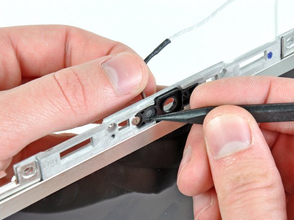

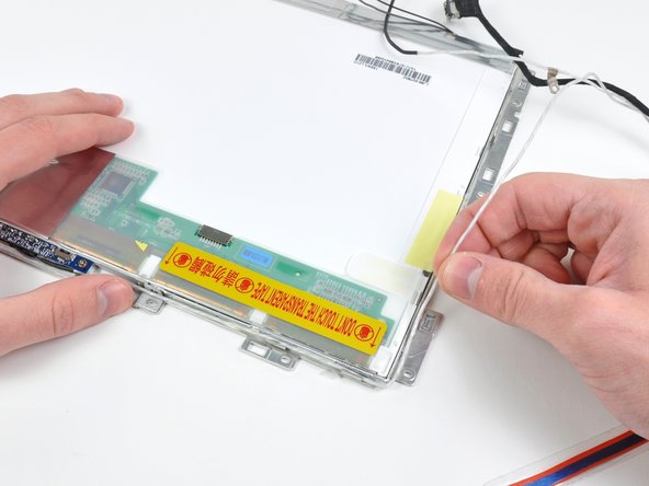

  • De-route the microphone cable from the clips along the side and top of the LCD assembly.

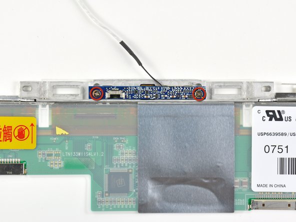

  • Remove the two 2.2 mm Phillips screws securing the iSight board to its bracket.

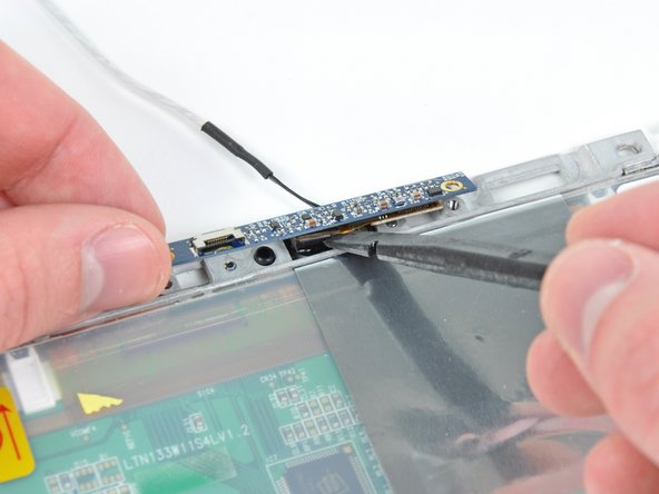

  • Use the flat end of a spudger to pry the camera out of its recess.
  • Remove the iSight from the display.
