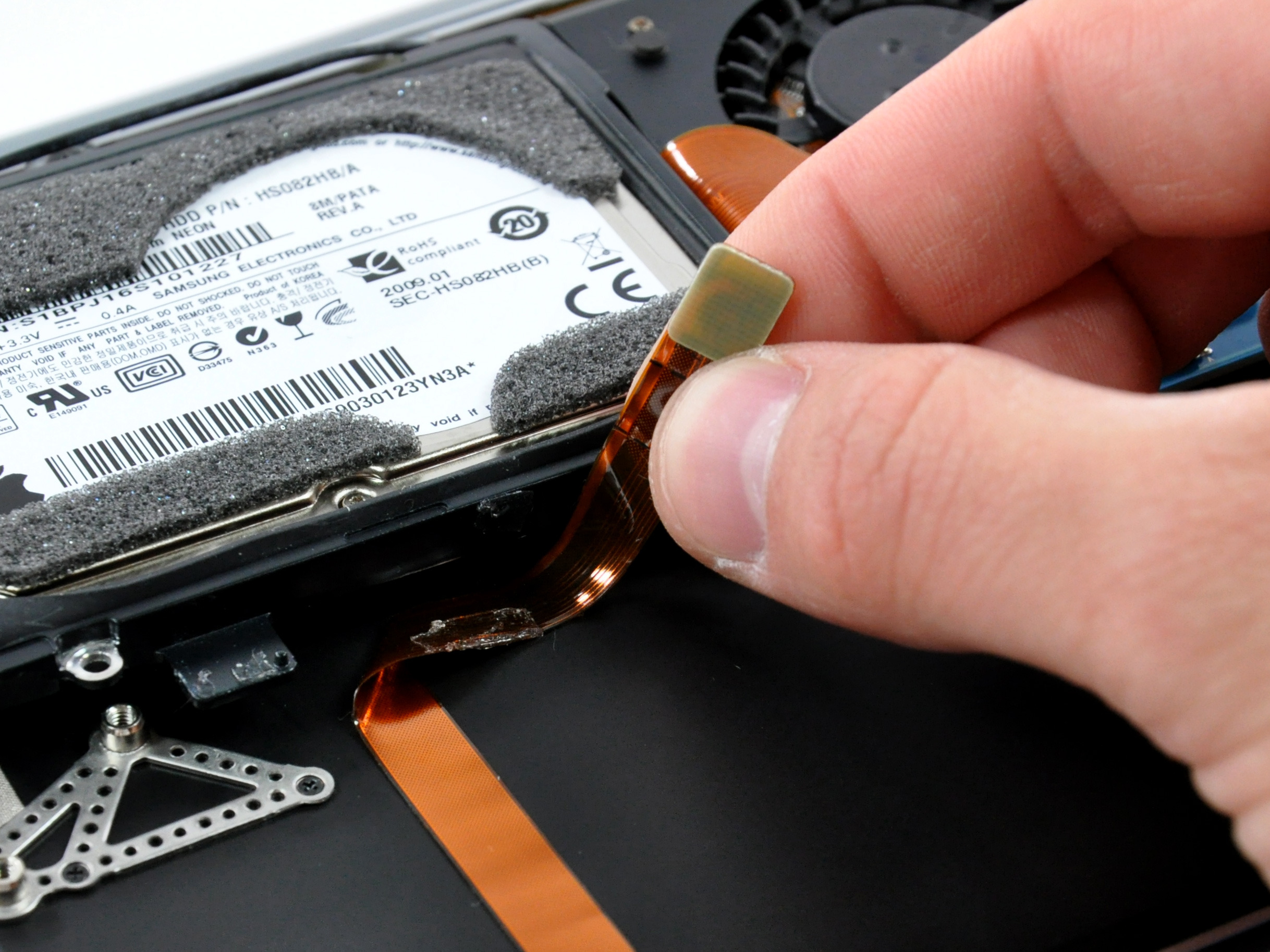

  • Lift the hard drive slightly and use a spudger to pry the audio cable connector up off the logic board.
  • Peel the audio cable off the adhesive securing it to the upper case.
