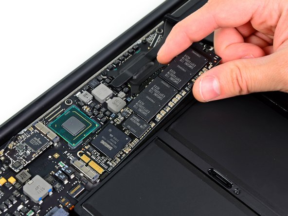

  4. MacBook Air 13" Mid 2012 Solid-State Drive Replacement, Solid-State Drive: step 4, image 1 of 1
    • Remove the single 2.9 mm T5 Torx screw securing the SSD to the logic board.
  5. MacBook Air 13" Mid 2012 Solid-State Drive Replacement: step 5, image 1 of 2 MacBook Air 13" Mid 2012 Solid-State Drive Replacement: step 5, image 2 of 2
    • To avoid damaging its socket, do not lift the end of the SSD excessively.
    • Slightly lift up the end of the SSD and pull it straight out of its socket on the logic board.
    • When reinstalling the SSD, be sure it is properly seated before reinstalling its retaining screw.

I understand this is probably a noob question, but can somebody explain what is preventing anybody from swapping a 128GB SSD for a 256GB?
Eugene General Ed - Reply
Eugene - nothing, I just followed this guide to upgrade from 256GB to 512GB. It's just that MBA 2012 SSDs are pretty hard to come by. I had to lurk on eBay for quite some time.
Julian - Reply
