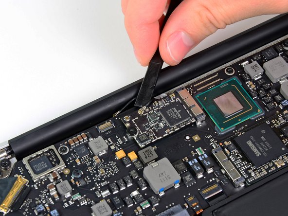

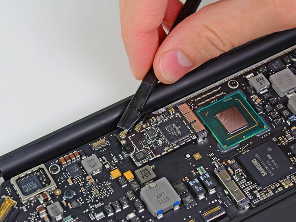

  • Use the flat end of a spudger to pry both antenna connectors up from their sockets on the AirPort/Bluetooth card.

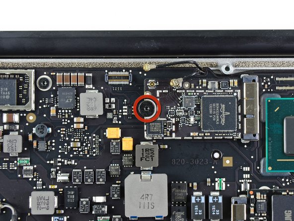

  • Remove the single 2.9 mm T5 Torx screw securing the AirPort/Bluetooth card to the logic board.

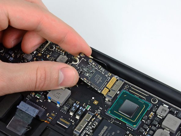

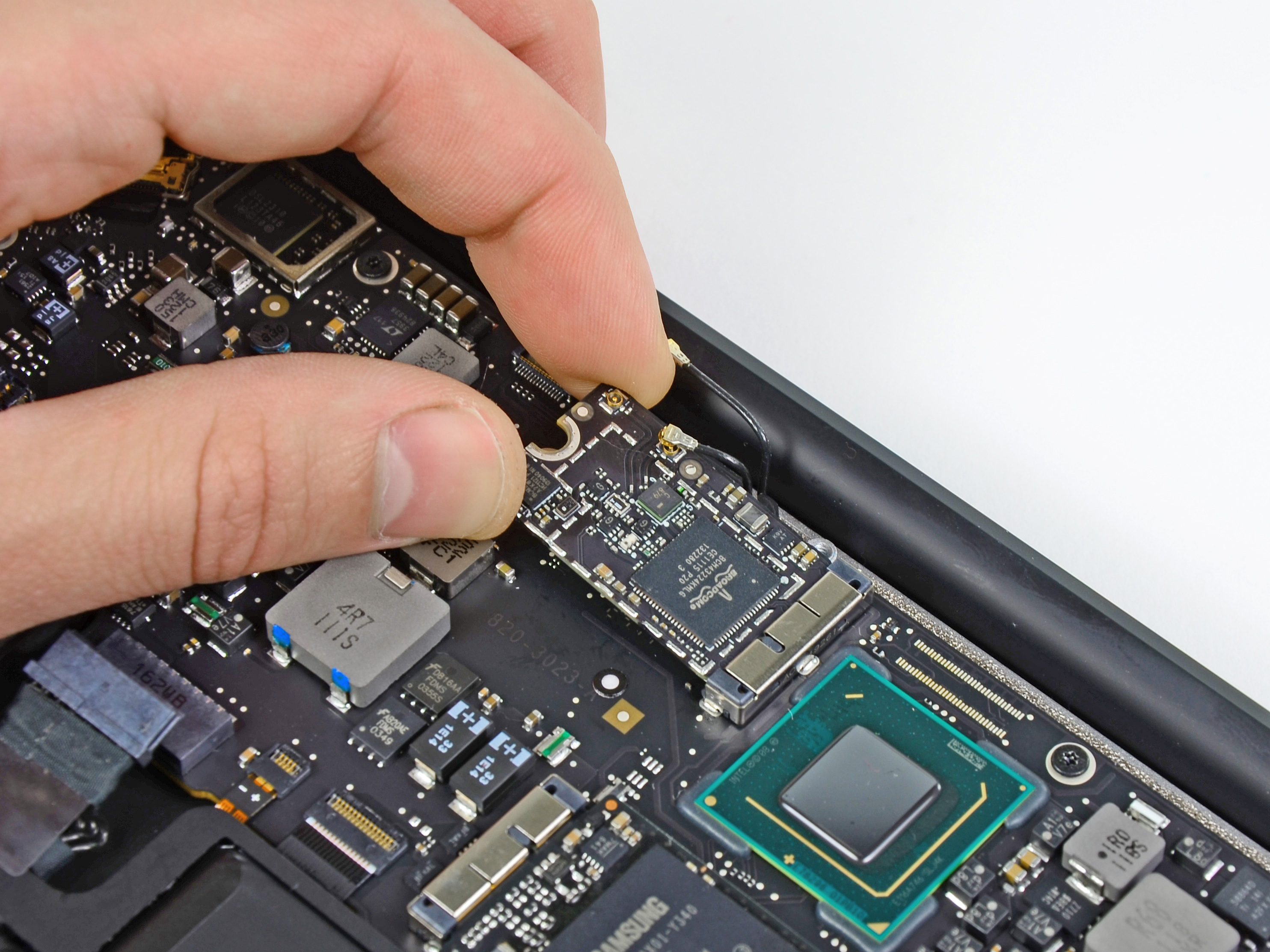

  • Slightly lift the free end of the AirPort/Bluetooth card and pull it out of its socket on the logic board.
  • To avoid damaging its socket on the logic board, do not excessively lift the free end of the AirPort/Bluetooth card.
  • Remove the AirPort/Bluetooth card from the Air.
