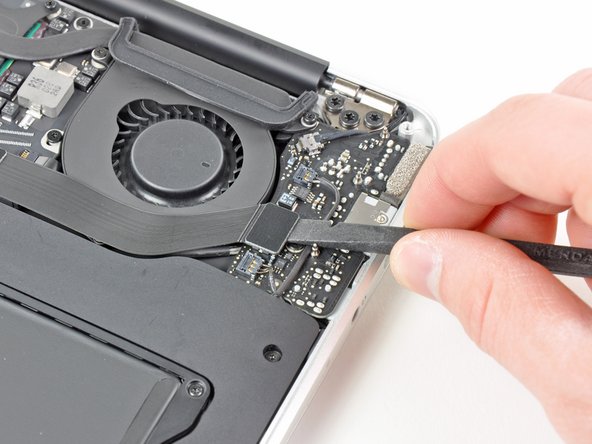

  4. MacBook Air 13" Late 2010 I/O Board Cable Replacement, I/O Board Cable: step 4, image 1 of 1
    • Use the flat end of a spudger to pry the I/O board cable connector upward out of its socket on the I/O board.

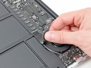

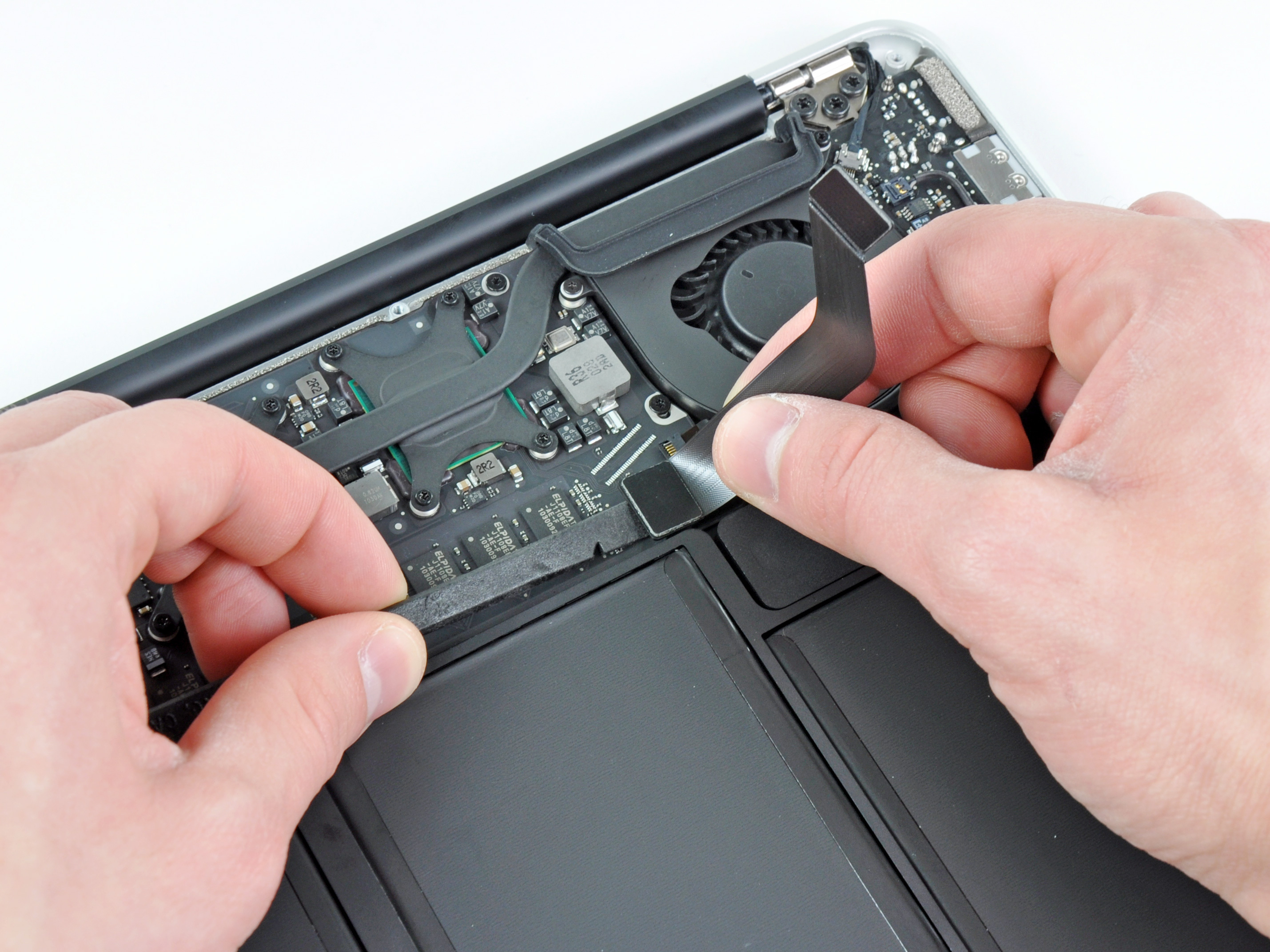

  5. MacBook Air 13" Late 2010 I/O Board Cable Replacement: step 5, image 1 of 2 MacBook Air 13" Late 2010 I/O Board Cable Replacement: step 5, image 2 of 2
    • The following connector has an especially deep socket. Use care when disconnecting it.
    • Carefully peel the I/O board cable from the top of the fan.
    • While gently pulling the I/O board cable upward near its connection to the logic board, use the tip of a spudger to pry upward on alternating sides of the connector to help "walk" it out of its socket.
    • Remove the I/O board cable.
