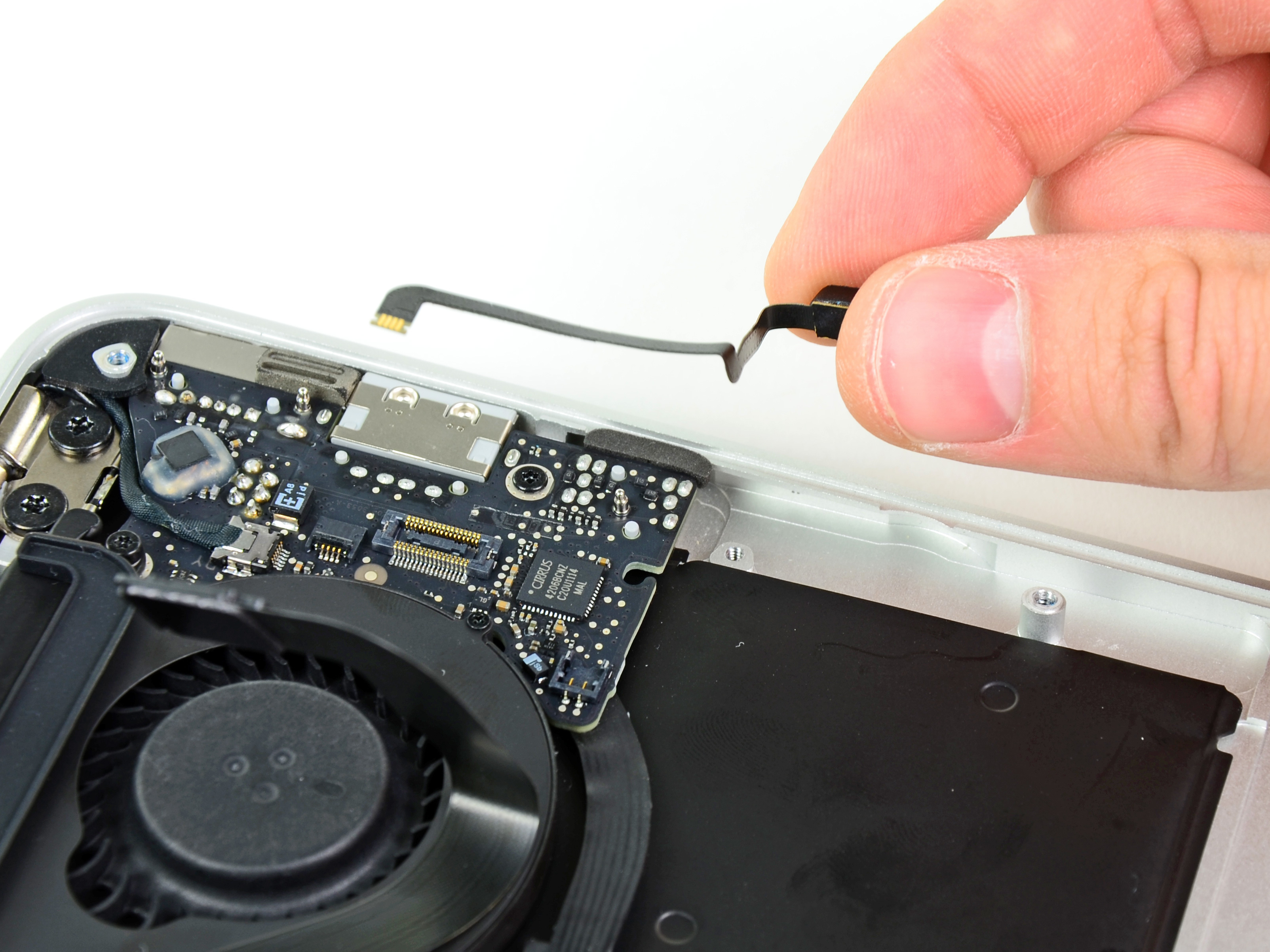

Add Note Edit Step 6 — Left Speaker  ¶
  • Use the flat end of a spudger to pry the I/O board cable connector upward out of its socket on the I/O board.
  • Bend the cable away from the I/O board.
Image #1
Add Note Edit Step 7  ¶
  • Use the tip of a spudger to de-route the left speaker cable from the notch cut into the edge of the I/O board.
Image #1
Add Note Edit Step 8  ¶
  • Use the flat end of a spudger to pry the left speaker connector up and out of its socket on the I/O board.
  • Pry upward from beneath the wires.
