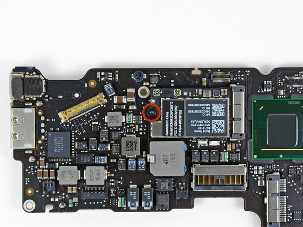

Add Note Edit Step 25 — Logic Board Replacement  ¶
  • Remove the single 2.9 mm T5 Torx screw securing the AirPort/Bluetooth card to the logic board.

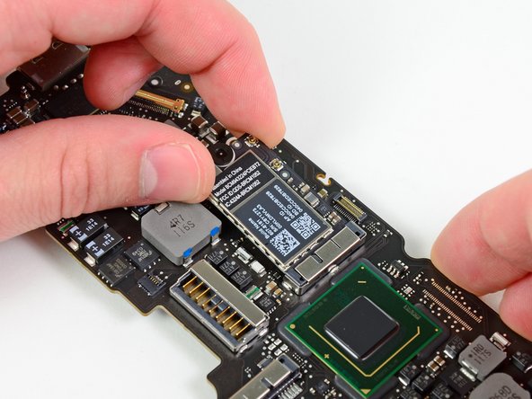

Add Note Edit Step 26  ¶
  • Slightly lift the free end of the AirPort/Bluetooth board and pull it out of its socket on the logic board.
  • To avoid damaging its socket on the logic board, do not excessively lift the free end of the AirPort/Bluetooth card.
  • Remove the AirPort/Bluetooth board from the logic board.

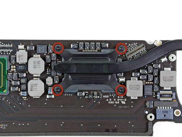

Add Note Edit Step 27  ¶
  • Remove the four 2.5 mm T5 Torx screws securing the heat sink to the logic board.

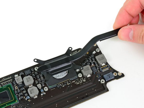

Image #1
Add Note Edit Step 28  ¶
  • If the heat sink seems to be stuck to the logic board after removing all four screws, use a spudger to carefully separate the heat sink from the faces of the CPU and GPU.
  • Remove the heat sink from the logic board.
  • Logic board remains.
  • When reinstalling the heat sink, be sure to apply a new layer of thermal paste. If you have never applied thermal paste before, we have a guide that makes it easy.
