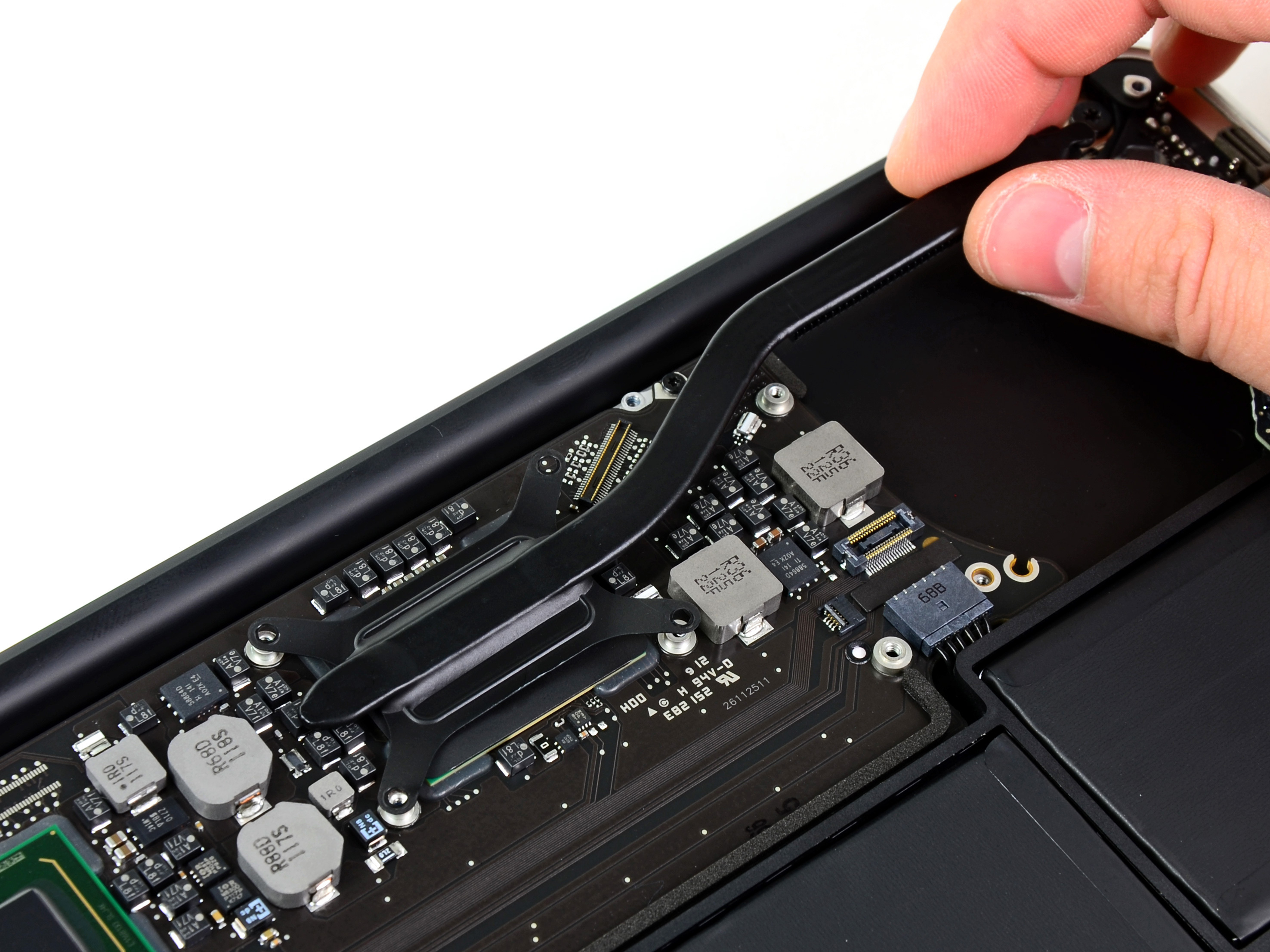

Image #1
Add Note Edit Step 12 — Heat Sink  ¶
  • Remove the four 2.5 mm T5 Torx screws securing the heat sink to the logic board.
Image #1
Add Note Edit Step 13  ¶
  • If the heat sink seems to be stuck to the logic board after removing all four screws, use a spudger to carefully separate the heat sink from the faces of the CPU and GPU.
  • Remove the heat sink from the logic board.
  • When reinstalling the heat sink, be sure to apply a new layer of thermal paste. If you have never applied thermal paste before, we have a guide that makes it easy.
