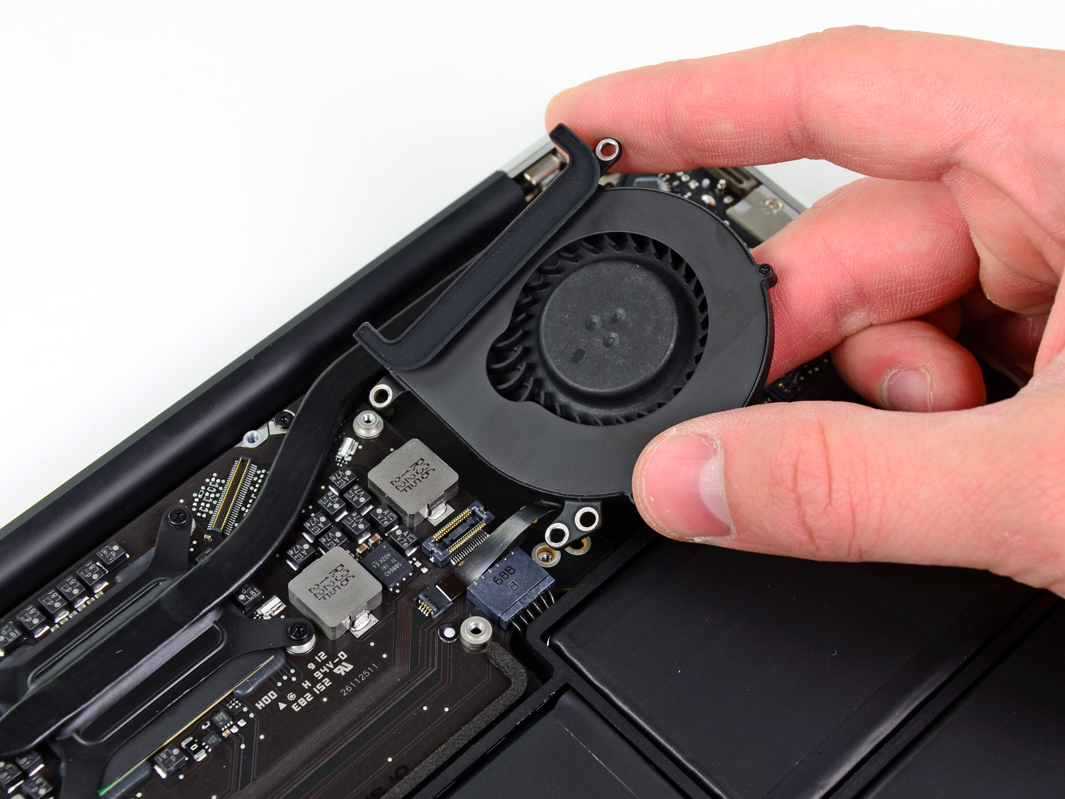

Add Note Edit Step 9 — Fan  ¶
  • Use the tip of a spudger to carefully flip up the retaining flap on the fan cable ZIF socket.
Image #1
Add Note Edit Step 10  ¶
  • Remove the following three screws securing the fan to the upper case:
    • Two 5.2 mm T5 Torx screws
    • One 3.6 mm T5 Torx screw
Image #1
Add Note Edit Step 11  ¶
  • Lift the fan out of the upper case and carefully pull the fan ribbon cable out of its socket as you remove it from the Air.
