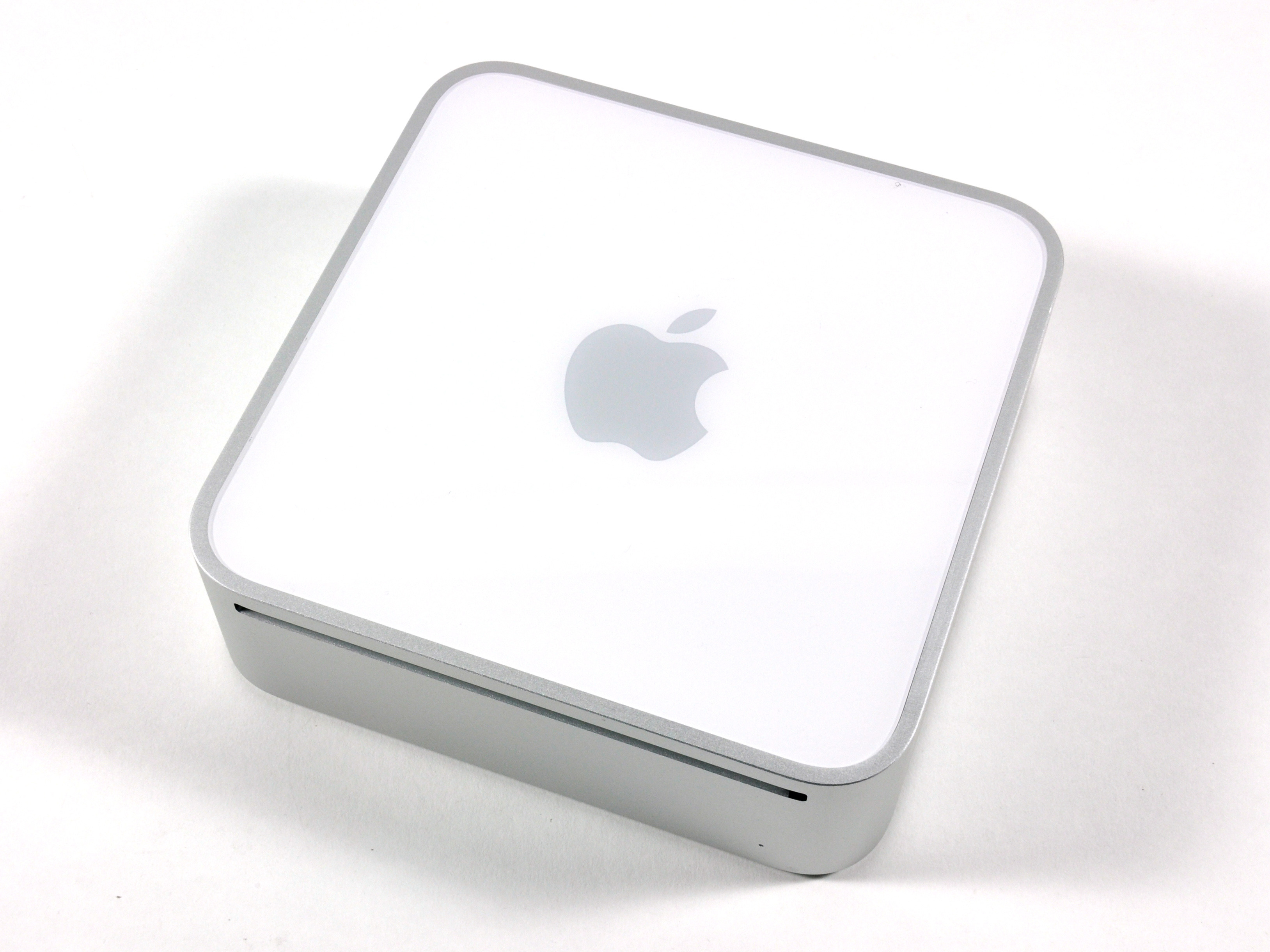

We tried to put a whopping terabyte worth of storage in a Mac mini -- and succeeded!
This guide walks you through the process of replacing the stock hard drive and optical drive with TWO 500 GB hard drives.
Warning: Although you're welcome to do this at home, this surgery is at your own risk. Make sure to back up any important data prior to working on your mini's hard drive. We'll post more information regarding heat and performance as soon as we have it available.
Image #1
Add Note Edit Step 1 — Terabyte Drive  ¶
  • We decided to see if we could stuff a full terabyte worth of storage into our new Mac mini. Why would anyone possibly want this much storage?
    • Bragging rights. Mac minis come with either 120, 250, or 320 GB standard. Yours has 1 TERABYTE.
    • Built-in Time Machine. Sure, you can hook up an external drive, but it's sure nice not to have cables everywhere.
    • RAID -- mirroring, striping, concatenating -- take your pick.
  • And seriously, with that much space, who needs an optical drive?
