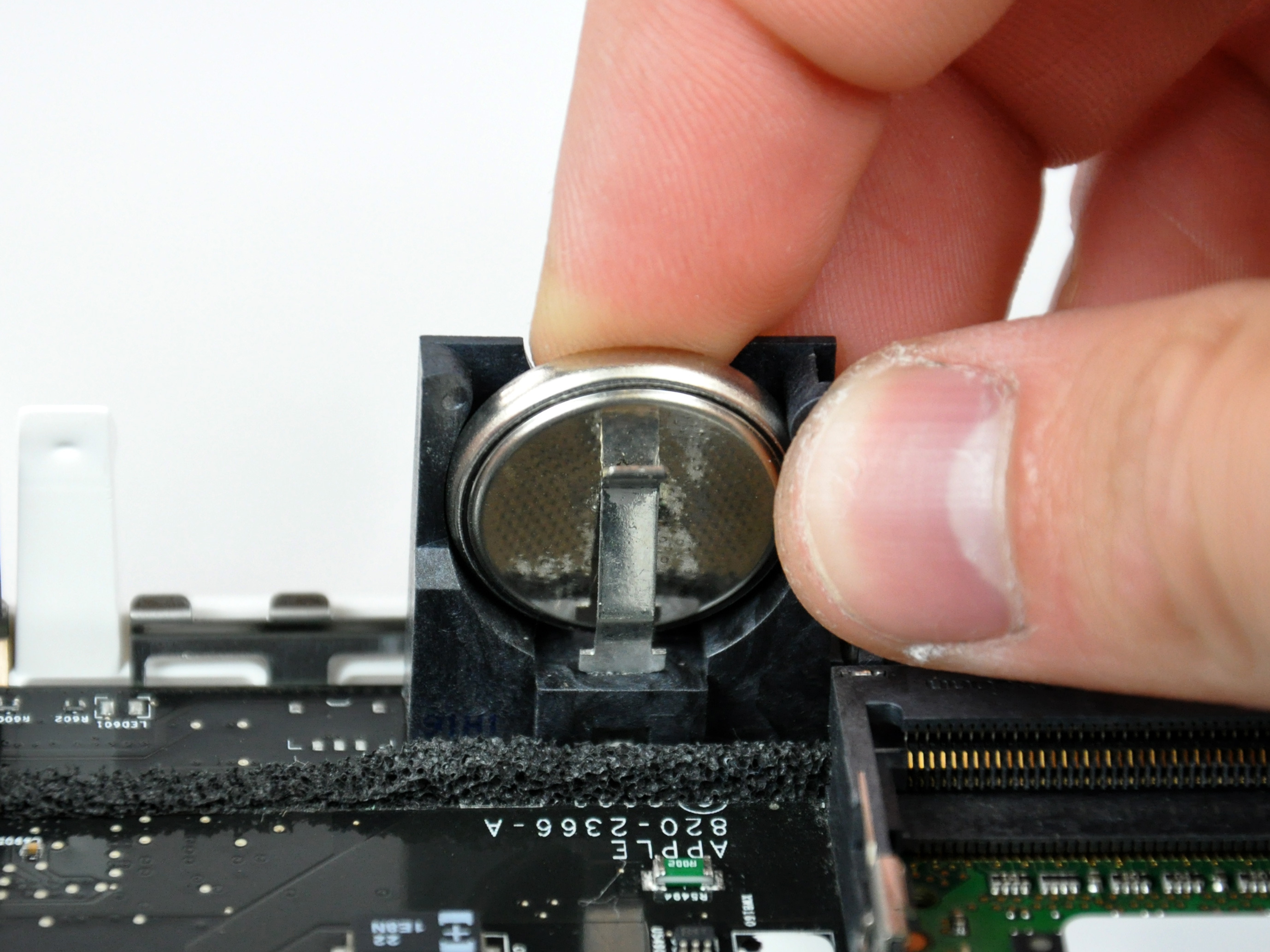

Installing Mac mini Model A1283 PRAM Battery
The time and date, as well as other settings, are kept by the PRAM battery when your machine is off.

Add Note Edit Step 6 — Internal Frame  ¶
  • In the next few steps you will be removing the AirPort and Bluetooth antennas (shown in red) from the internal frame. Be very careful, as breaking the brackets will require replacing the internal frame.
  • We will first remove the AirPort antenna, located in the lower left corner of this picture.
Image #1 Image #2
Add Note Edit Step 7  ¶
  • Slightly squeeze the two retaining arms toward each other and lift the AirPort antenna off its post.
  • Squeezing the two posts excessively will surely break them off the internal frame. Work delicately.
  • During reinstallation, you will have to slightly squeeze the two posts together so they fit into the openings on the AirPort antenna board.
Image #1 Image #2
Add Note Edit Step 8  ¶
  • The two Bluetooth antenna boards simply lift off the internal frame.
  • Grab the Bluetooth antenna nearest the port side of the computer by the edges of the board and pull it straight up off the internal frame.
    • Pull carefully, as it may offer significant resistance and release suddenly.
