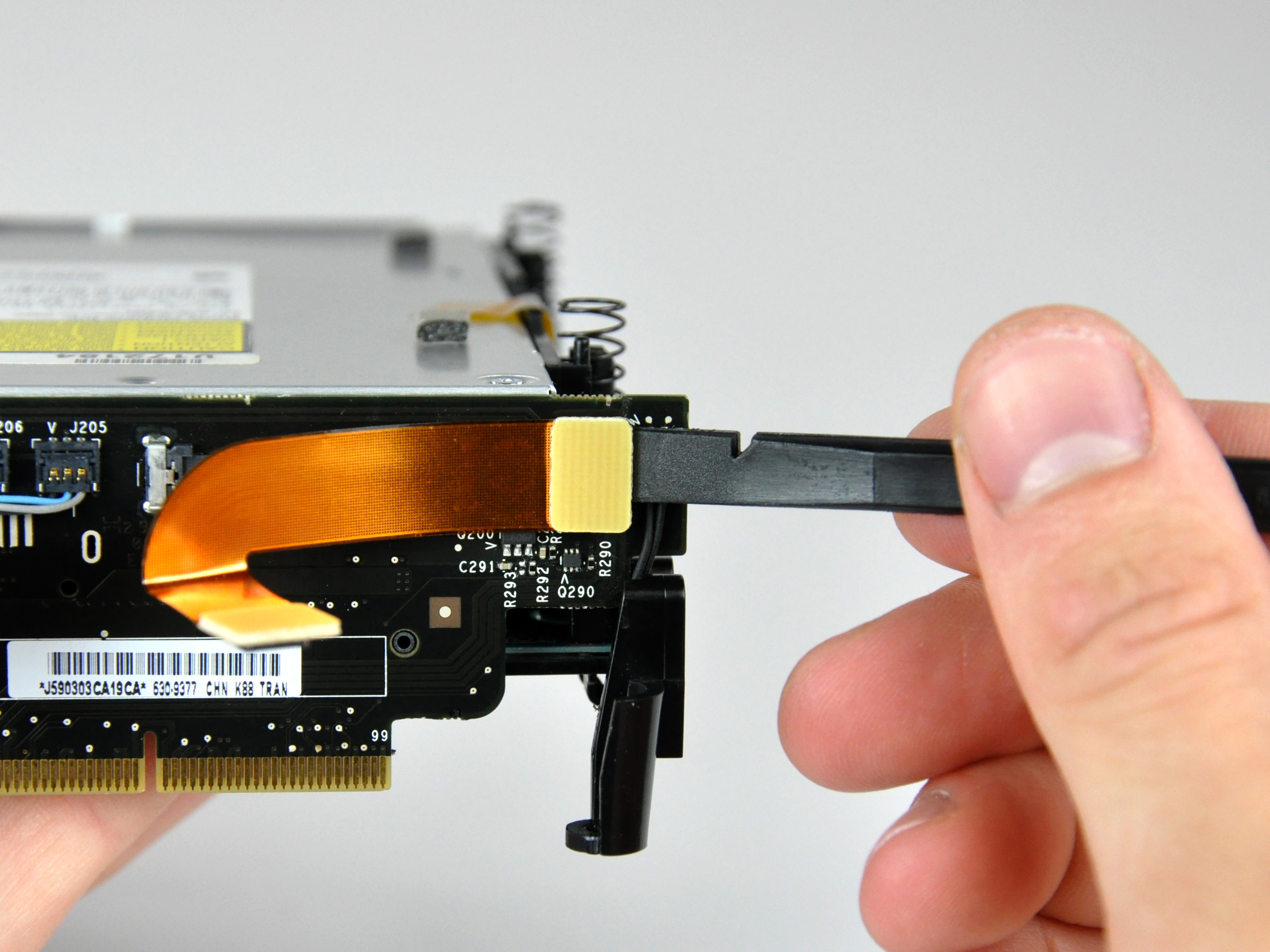

Add Note Edit Step 13 — Interconnect Board  ¶
  • Use the flat end of a spudger to pry the audio ribbon cable connector up off the interconnect board.
Image #1

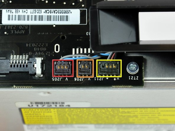

Add Note Edit Step 14  ¶
  • Use the flat end of a spudger to pry the following connectors up off the interconnect board:
    • Fan cable.
    • Speaker cable.
    • IR board cable.
Image #1

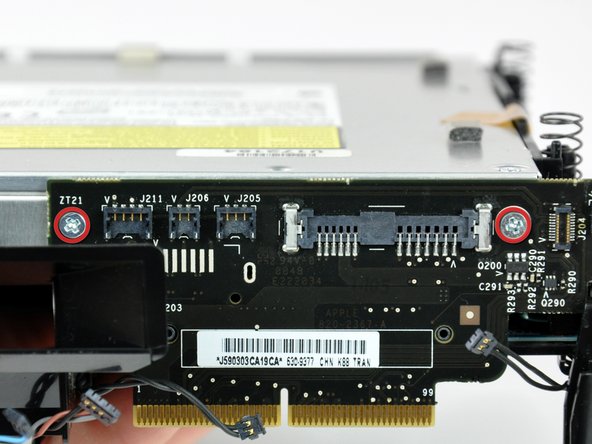

Add Note Edit Step 16  ¶
  • Remove the two Phillips screws securing the interconnect board to the optical drive.
Image #1 Image #2

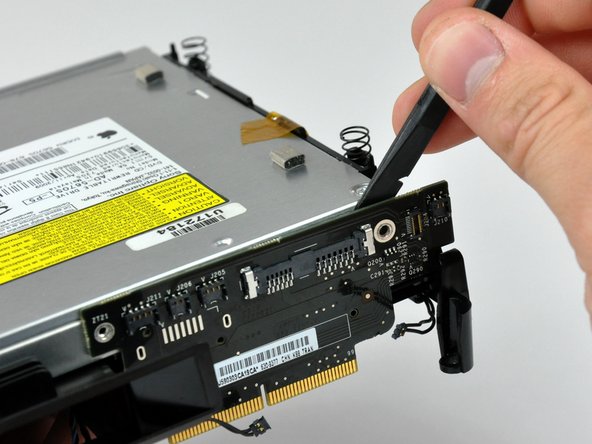

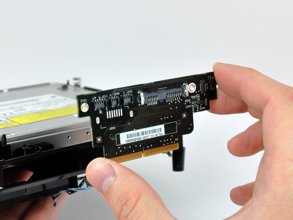

Add Note Edit Step 17  ¶
  • Use the flat end of a spudger to separate the interconnect board from the optical and hard drives.
  • Pull the interconnect board away from the drives and remove it from the internal frame.
