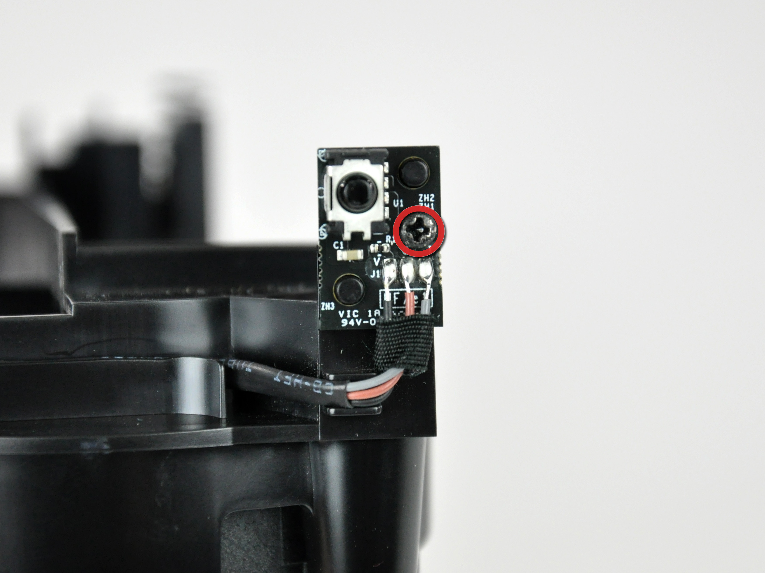

  22. Mac mini Model A1283 IR Board & Cable Replacement, IR Board & Cable: step 22, image 1 of 1
    • Remove the single Phillips screw securing the IR board to the internal frame.
