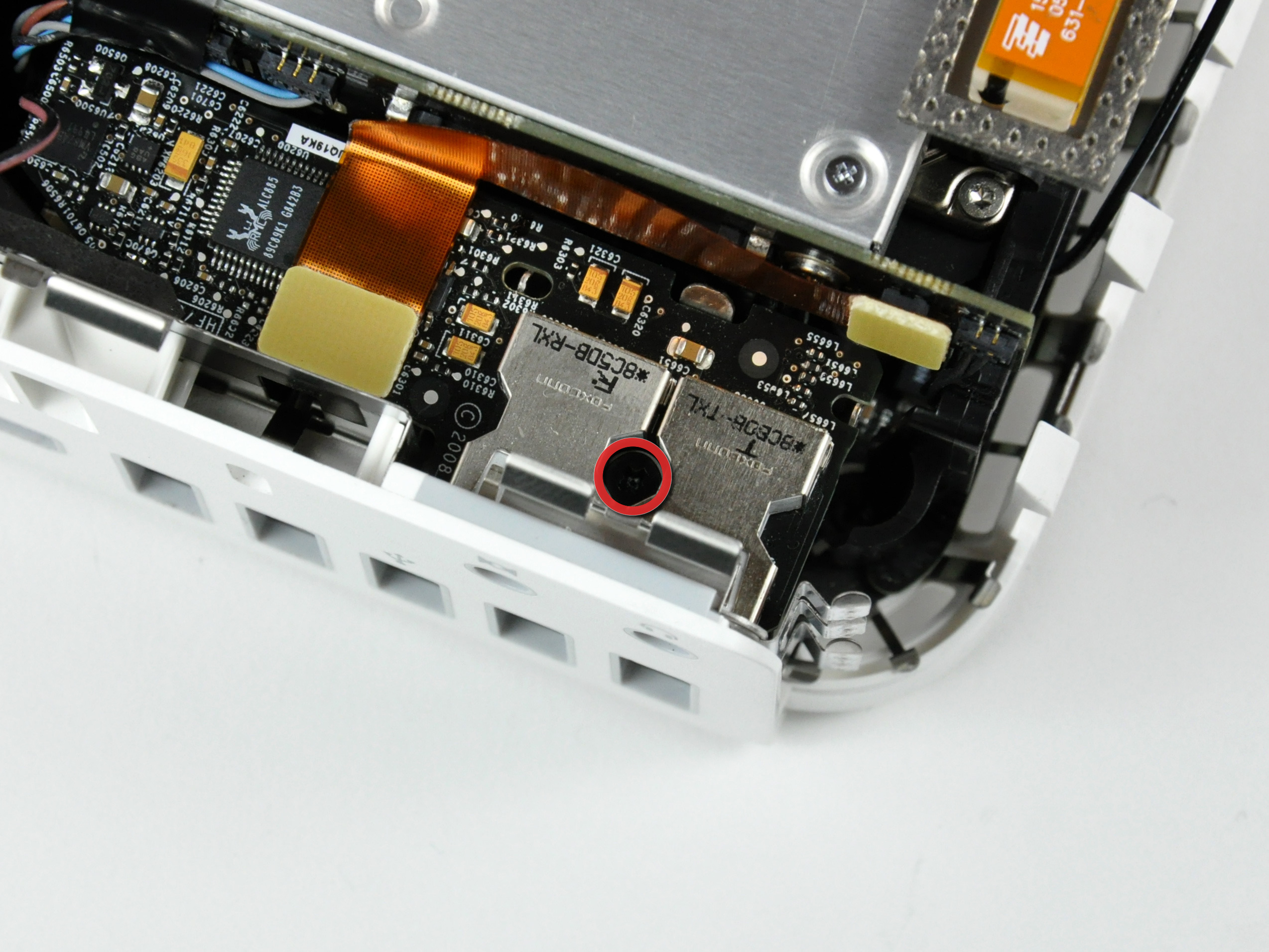

  7. Mac mini Model A1283 Audio Board Replacement, Audio Board: step 7, image 1 of 1
    • Remove the single Phillips screw between the headphone and microphone jacks on the audio board.

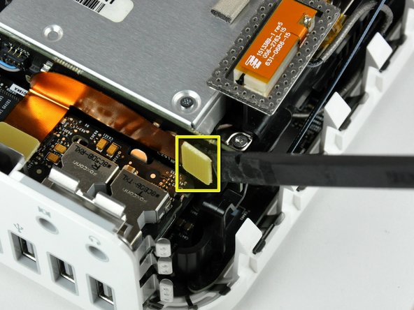

  8. Mac mini Model A1283 Audio Board Replacement: step 8, image 1 of 1
    • Use the flat end of a spudger to pry the audio ribbon cable connector off the interconnect board.

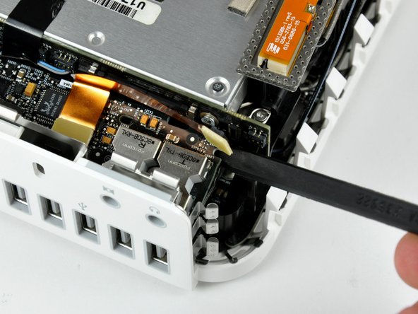

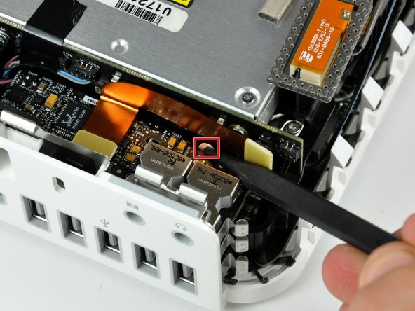

  9. Mac mini Model A1283 Audio Board Replacement: step 9, image 1 of 2 Mac mini Model A1283 Audio Board Replacement: step 9, image 2 of 2
    • Use the tip of a spudger to depress the audio board retaining clip (shown in red) to release the audio board from the bottom housing.
    • Lift the audio board from its free end and remove it from the mini.
    • Don't forget to transfer the audio ribbon cable to your new audio board.
