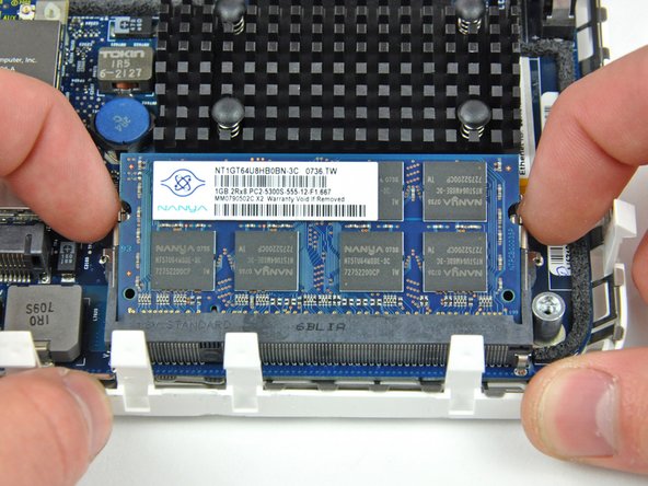

Add Note Edit Step 15 — RAM  ¶
  • Simultaneously pull the tabs on each side of the RAM chip away from the center of the chip. These tabs lock the chip in place and releasing them will cause the chip to "pop" up.
Image #1
Add Note Edit Step 16  ¶
  • Pull the RAM chip directly out from its connector.
  • If there are two RAM chips installed, repeat the above procedure for the second chip.
