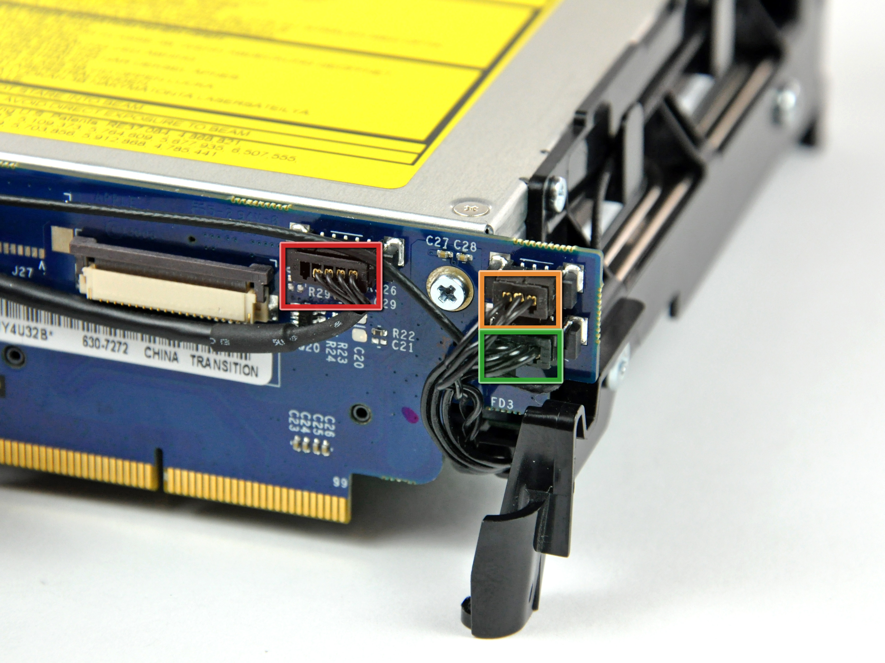

Add Note Edit Step 6 — Internal Frame  ¶
  • Later in this guide you will remove several recessed Phillips screws. Bit drivers are generally too large to fit in the recesses, so be sure to have a thin shafted Phillips screwdriver on hand.
  • First remove the AirPort antenna (the larger of the two), located near the power button.
  • Slightly squeeze the two retaining arms toward each other and lift the AirPort antenna off its post.
  • Squeezing the two posts excessively will surely break them off the internal frame. Work delicately.
  • During reinstallation, you will have to slightly squeeze the two posts together so they fit into the openings on the AirPort antenna board.
Image #1 Image #2
Add Note Edit Step 7  ¶
  • Use the tip of a spudger to slightly lift the left side of the ZIF cable lock up from its socket.
  • The ZIF cable lock will lift about 1 mm and stop. Do not try to completely remove the ZIF cable lock.
Image #1
Add Note Edit Step 8  ¶
  • Lift the audio board ribbon cable up out of its socket.
  • If it refuses to lift from its socket, the ZIF cable lock is not fully released. Make sure it is evenly lifted about 1 mm from the socket on the interconnect board.
