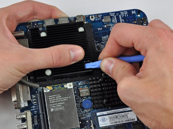

  • Now that the processor is in place, turn your attention to the heat sink.
  • Apple uses a thermally conductive film that must be removed prior to reinstalling the heat sink.
  • Use a razor blade (or anyother flat object such as a credit card, etc.) to remove all of the old solidified thermal material from the heat sink.
  • Next use a small amount of rubbing alcohol to remove all traces of the old thermal material.
  • Allow the heat sink to dry before proceeding.

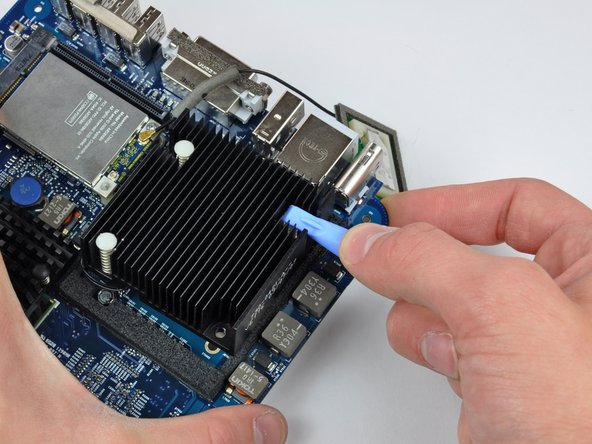

  • Lay the heat sink on the AirPort card and use a spudger to reconnect the heat sink thermal sensor.
Image #1
Add Note Edit Step 31  ¶
  • Position the heat sink the same way it will permanently sit before lowering it onto the processor to avoid spreading thermal paste on regions not in contact with the processor.
  • Gently lower the heat sink onto the processor.
