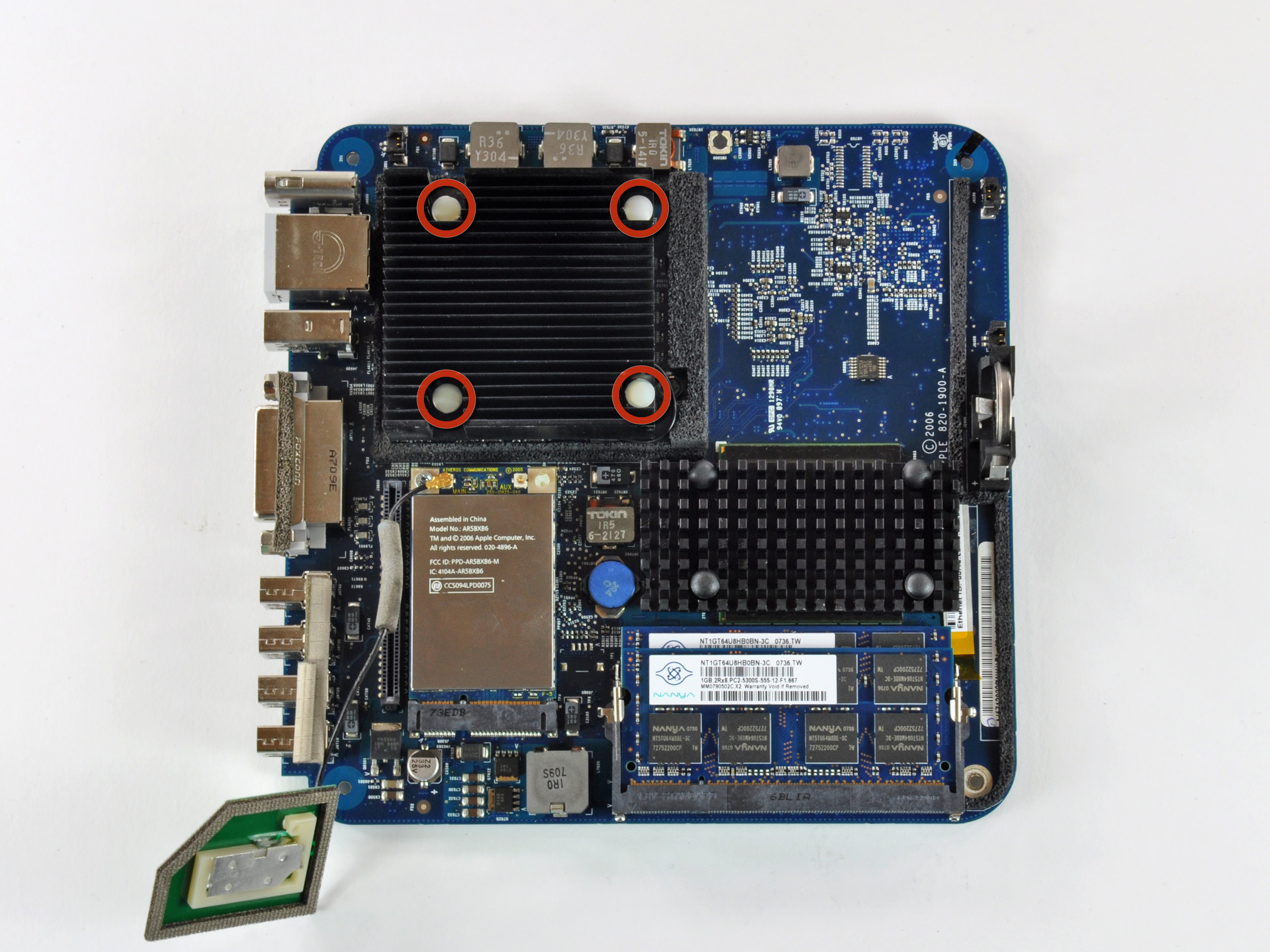

  21. Mac mini Model A1176 CPU Replacement, CPU: step 21, image 1 of 2 Mac mini Model A1176 CPU Replacement, CPU: step 21, image 2 of 2
    • Before removing the processor you must first remove the aluminum heat sink.
    • To avoid bending the fins, don't squeeze the upper portion of the heat sink perpendicular to the length of the fins.
    • A spring loaded plastic pin at each corner of the heat sink holds it firmly against the face of the processor.
    • The pins have barbs at one end that expand once the pin passes through the logic board. The barbs must be squeezed together to fit through the holes in the logic board. Use extreme caution when squeezing the barbs together with pliers near the exposed face of the logic board.
  22. Mac mini Model A1176 CPU Replacement: step 22, image 1 of 2 Mac mini Model A1176 CPU Replacement: step 22, image 2 of 2
    • This step requires working with both hands and may be better accomplished with the logic board sitting in your lap.
    • Using a plastic opening tool (or similar) in one hand, push down one pin holding the heat sink on the logic board. The spring under the pin will provide moderate resistance.
    • While holding the pin down from the heat sink side of the board, use a pair of pliers in your other hand on the underside of the board to squeeze both barbs against the plastic shaft of the pin.
    • With both barbs squeezed together, push the pin through its hole in the logic board.
    • Repeat this process for each of the four pins holding the heat sink on the logic board.
