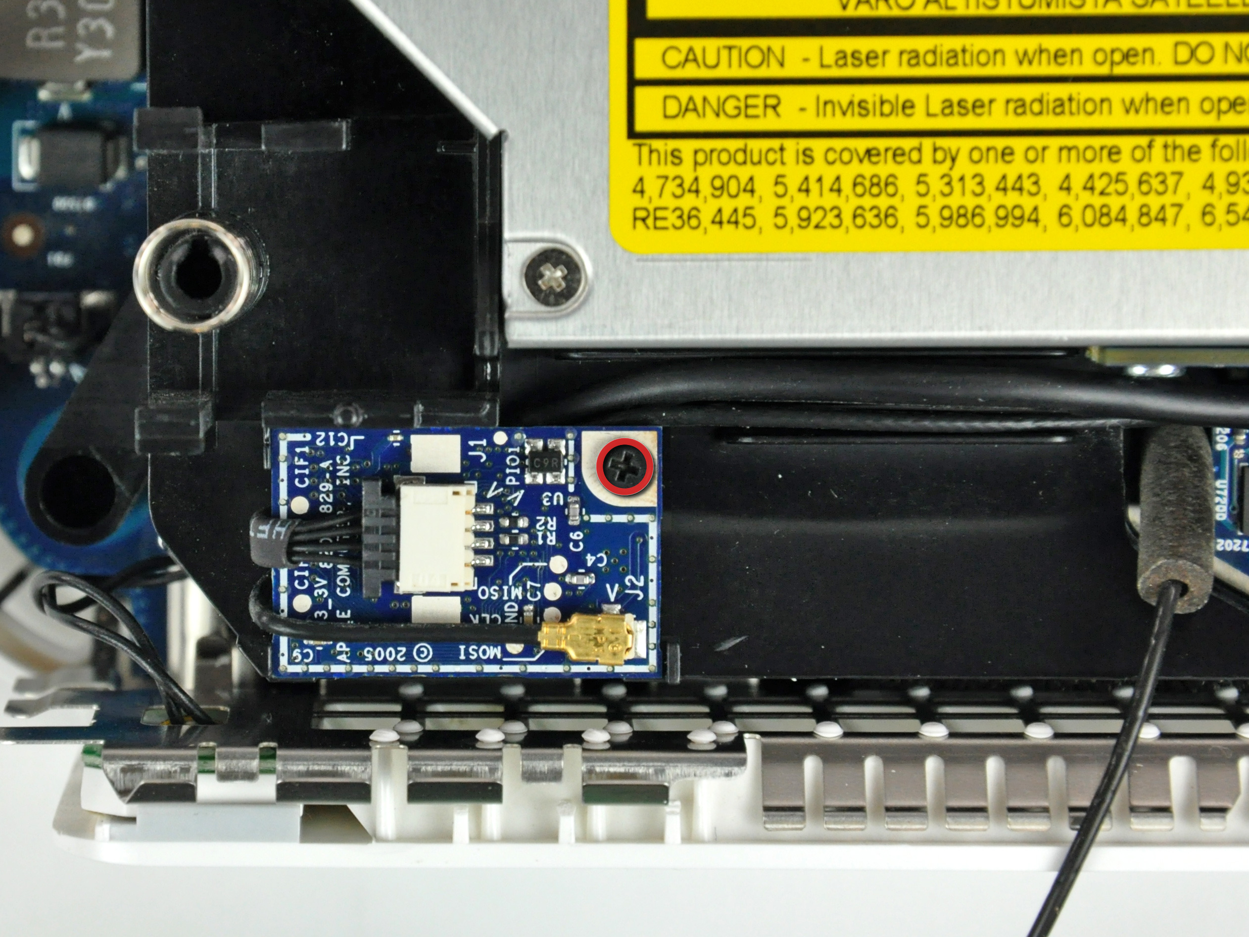

Add Note Edit Step 6 — Bluetooth Board  ¶
  • Remove the single Phillips screw securing the Bluetooth board to the internal frame.
Image #1
Add Note Edit Step 7  ¶
  • Disconnect the Bluetooth cable connector by pulling it straight away from its socket.
Image #1
Add Note Edit Step 8  ¶
  • Use the flat end of a spudger to pry the Bluetooth antenna cable connector up off the Bluetooth board.
