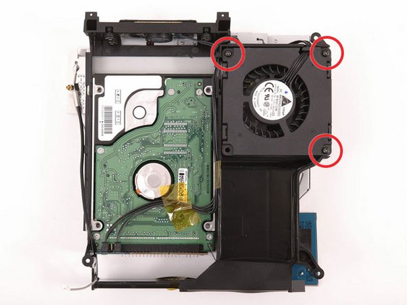

Add Note Edit Step 10 — Fan  ¶
  • Flip the mass storage assembly over so that the fan faces up.
  • Remove the three long, black Phillips screws from the corners of the fan. These screws are strongly threaded, and will offer significant resistance.
  • There is no screw in the bottom left corner.

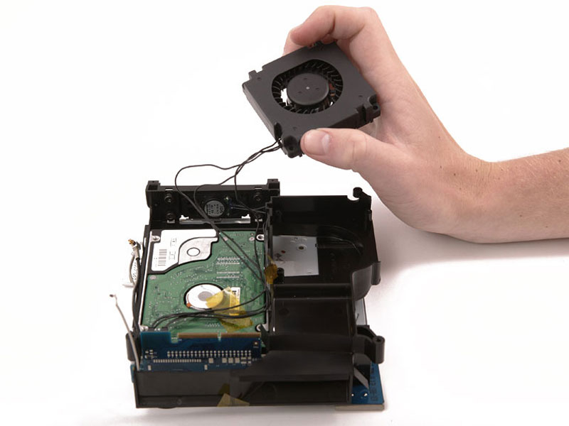

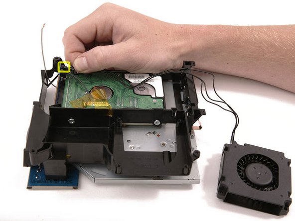

Image #1
Add Note Edit Step 11  ¶
  • Lift the fan up and deroute its cable from the plastic framework and the bottom of the hard drive, removing tape as necessary.
Image #1
Add Note Edit Step 12  ¶
  • The cable you're about to remove is very fragile - do not pull directly on the wires. Instead, try to pry up the connector directly, using your fingernails or a small flathead screwdriver if necessary.
  • Disconnect the fan connector from the interface board.
