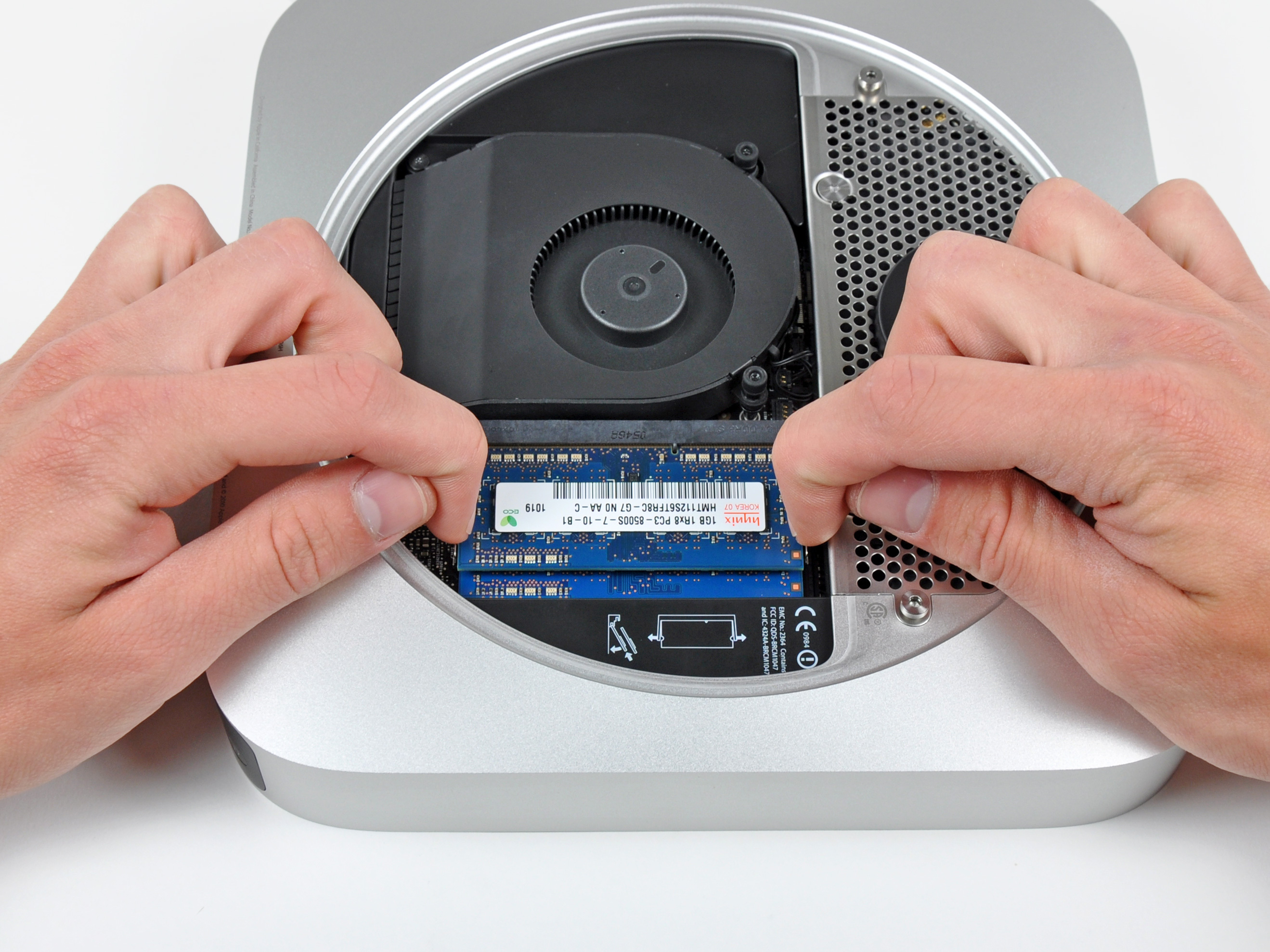

  3. Mac mini Mid 2011 RAM Replacement, RAM: step 3, image 1 of 2 Mac mini Mid 2011 RAM Replacement, RAM: step 3, image 2 of 2
    • Release the tabs on each side of the RAM chip by simultaneously pushing each tab away from the chip.
    • These tabs lock the chip in place and releasing them will cause the chip to "pop" up.
    • After the RAM chip has popped up, pull it straight out of its socket.
    • Repeat this process if a second RAM chip is installed.

I have just fitted the two 8 GB rams but despite refitting several times my computer is only reading one card. It simply says 8 GB memory and one space available. The cards slotted tightly and clicked in position. I have tried exerting a little pressure on the cards to see if there was not good contact but they appear connected. Any ideas please?
Graham - Reply
I had difficulty, only one card is read, the computer says i slot available. Have fitted several times and exerted pressure to ensure contact but still only one card read. Any ideas please?
Graham - Reply
You should try to find out if the DIMM or the slot is broken: I suppose you tried to switch the DIMMs? The easiest way is to try only one DIMM (memory module), first in the lower slot, then in the upper slot.
IMPORTANT: reset the PRAM after altering the configuration, i.e. after moving a DIMM to another slot. (Hold Cmd+Opt+P+R when turning on the Mac and keep holding the keys until you've heared the start chime two times.)
https://support.apple.com/en-us/HT204063
If the one DIMM works in both slots, the slots are okay. Now try the other DIMM. If the second DIMM also works in both slots, I frankly have no other idea than to try a different version of OS X to rule out the possibility of a software problem.
muttztfz -
