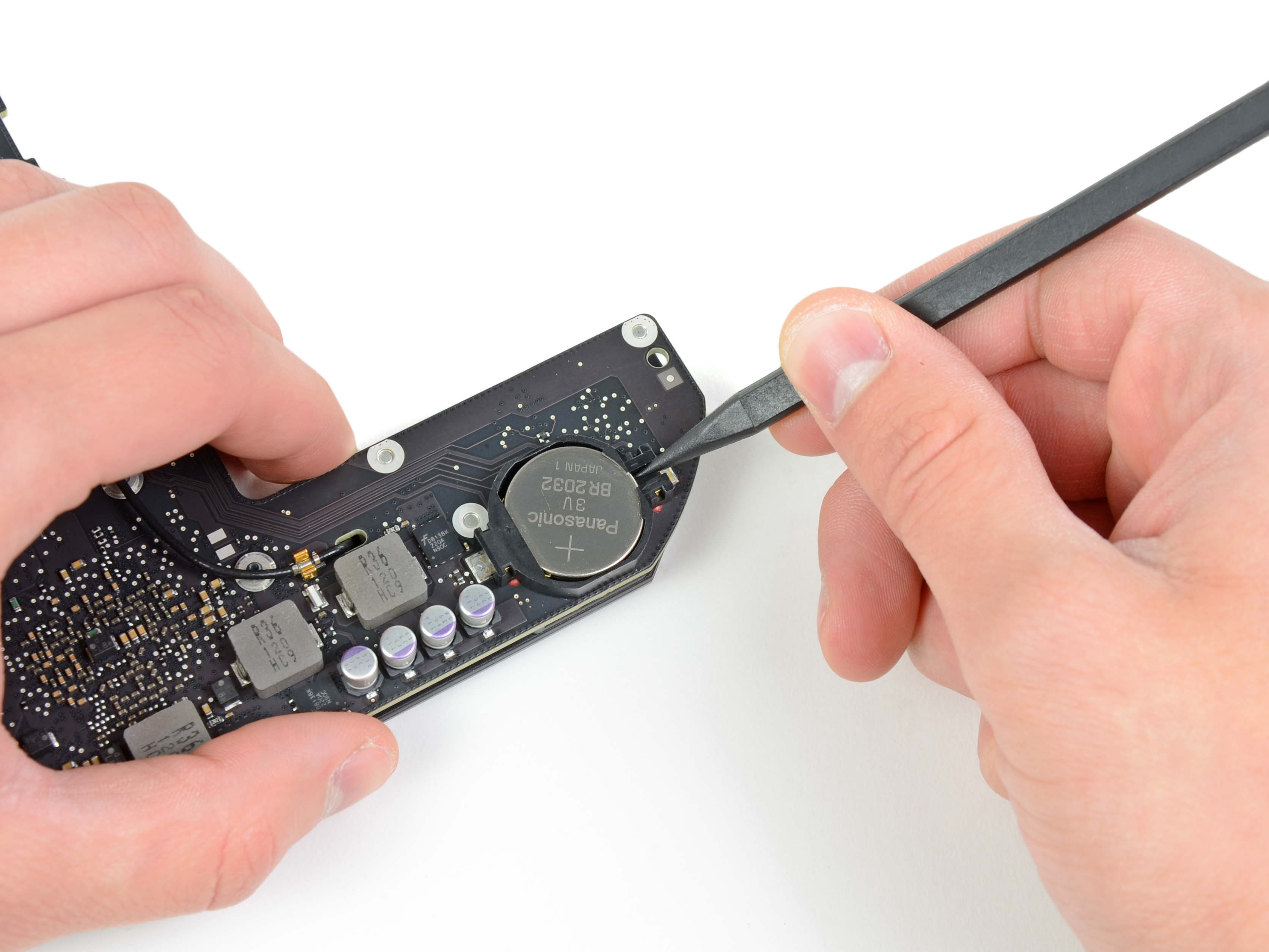

Add Note Edit Step 18 — PRAM Battery  ¶
  • The PRAM battery is located on the top side of the logic board.
  • Use the tip of a spudger to carefully pry the PRAM battery up and out of its holder on the logic board.
Image #1
Add Note Edit Step 19  ¶
  • Remove the PRAM battery from the logic board.
  • The PRAM battery is a commonly available BR2032 coin-cell.
