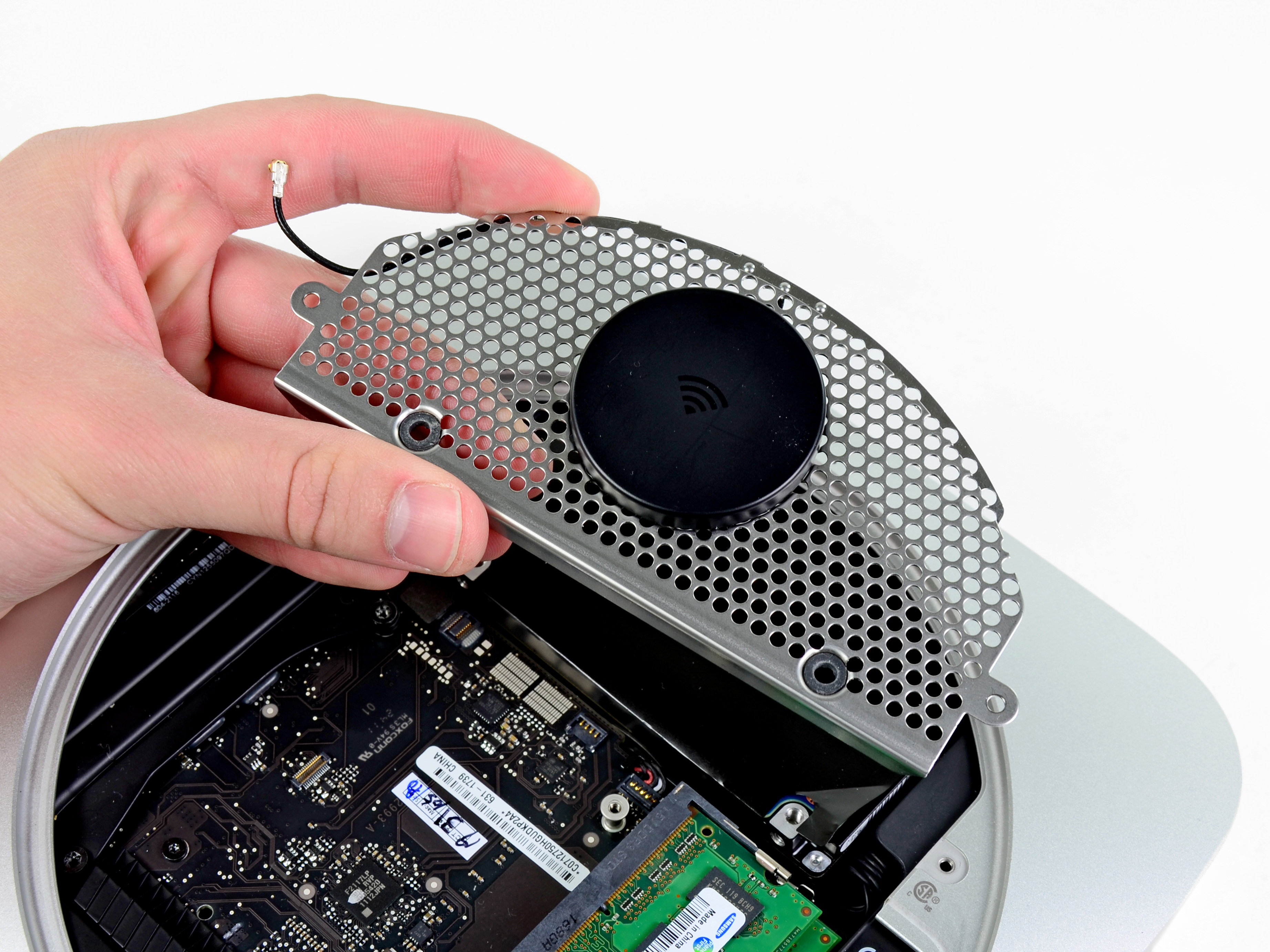

Installing Mac Mini Mid 2011 Antenna Plate
Removing the perforated steel antenna plate.
Use this guide to replace the antenna plate that serves as a mount for the antenna as well as the hard drive.
Sections
Image #1 Image #2
Add Note Edit Step 1 — Bottom Cover  ¶
  • Place your thumbs in the depressions cut into the bottom cover.
  • Rotate the bottom cover counter-clockwise until the white dot painted on the bottom cover is aligned with the ring inscribed on the outer case.
Image #1
Add Note Edit Step 2  ¶
  • Tilt the mini enough to allow the bottom cover to fall away from the outer case.
  • Remove the bottom cover and set it aside.
Image #1
Add Note Edit Step 3 — Fan  ¶
  • Remove the two 11.3 mm T6 Torx screws securing the fan to the logic board near the antenna plate.
Image #1
Add Note Edit Step 4  ¶
  • Lift the ear of the fan nearest the RAM up off the standoff secured to the outer case.
  • Removing the standoff screw is not necessary to remove the fan. You need only raise the fan enough to lift it off the standoff screw.
Image #1
Add Note Edit Step 5  ¶
  • Lift the fan out of the mini for enough clearance to access its connector.
  • Carefully pull the fan cables upward to lift the fan connector up out of its socket on the logic board.
  • Remove the fan.
Image #1
Add Note Edit Step 6 — Cowling  ¶
  • Remove the single 3.5 mm T6 Torx screw securing the cowling to the heat sink.
Image #1
Add Note Edit Step 7  ¶
  • Lift the cowling from the end nearest the antenna plate.
  • Rotate the cowling away from the outer case and remove it from the mini.
Image #1
Add Note Edit Step 8 — Antenna Plate  ¶
  • Remove the following screws securing the antenna plate to the mini:
    • Two 6.6 mm T8 Torx screws
    • Two 5.0 mm T8 Torx or 2.0 mm Hex screws (either screwdriver will work)
