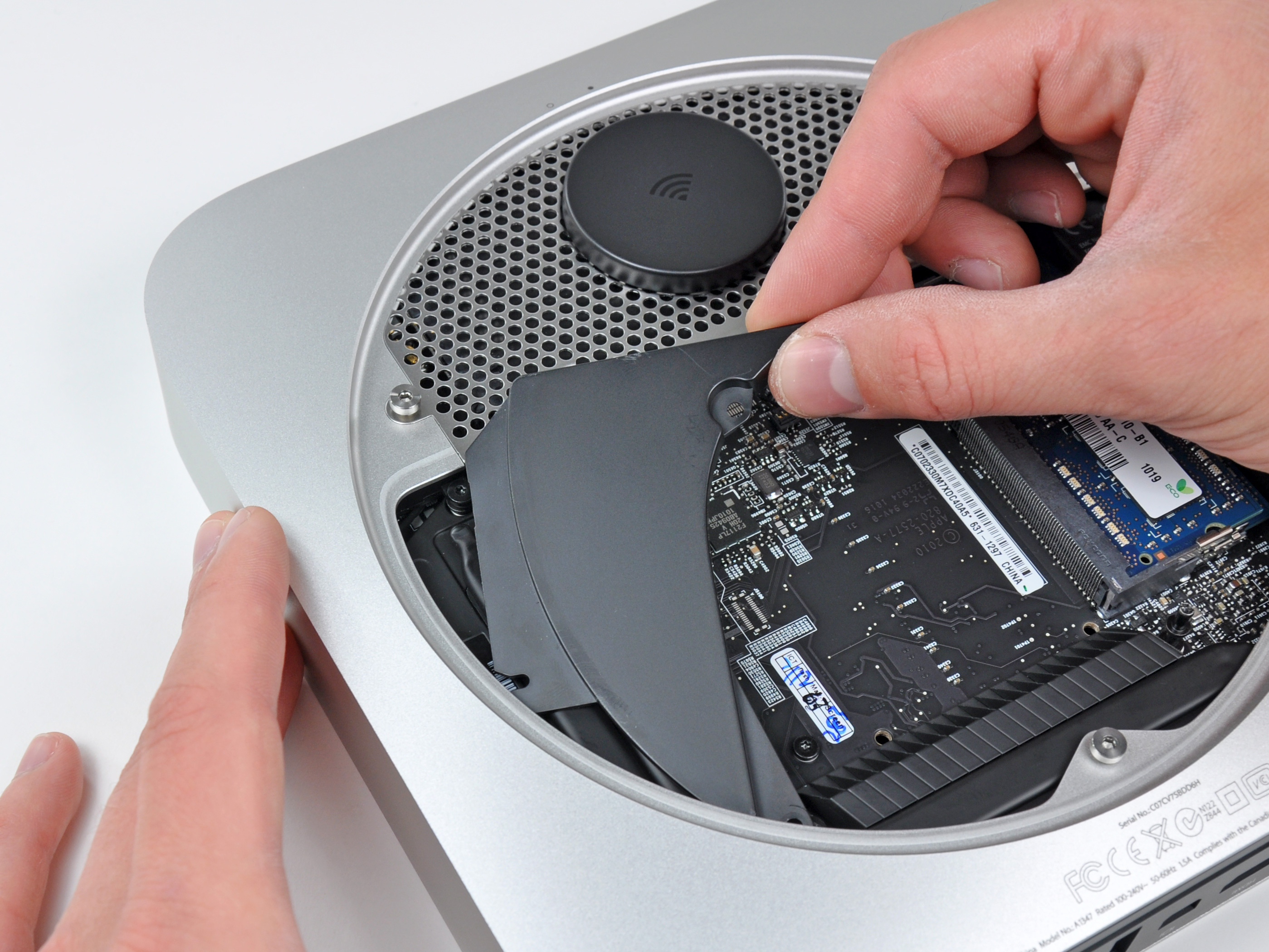

Add Note Edit Step 6 — Cowling  ¶
  • Remove the single 3.5 mm T6 Torx screw securing the cowling to the heat sink.
Image #1
Add Note Edit Step 7  ¶
  • Lift the cowling from the end nearest the antenna plate.
  • Rotate the cowling away from the outer case and remove it from the mini.
