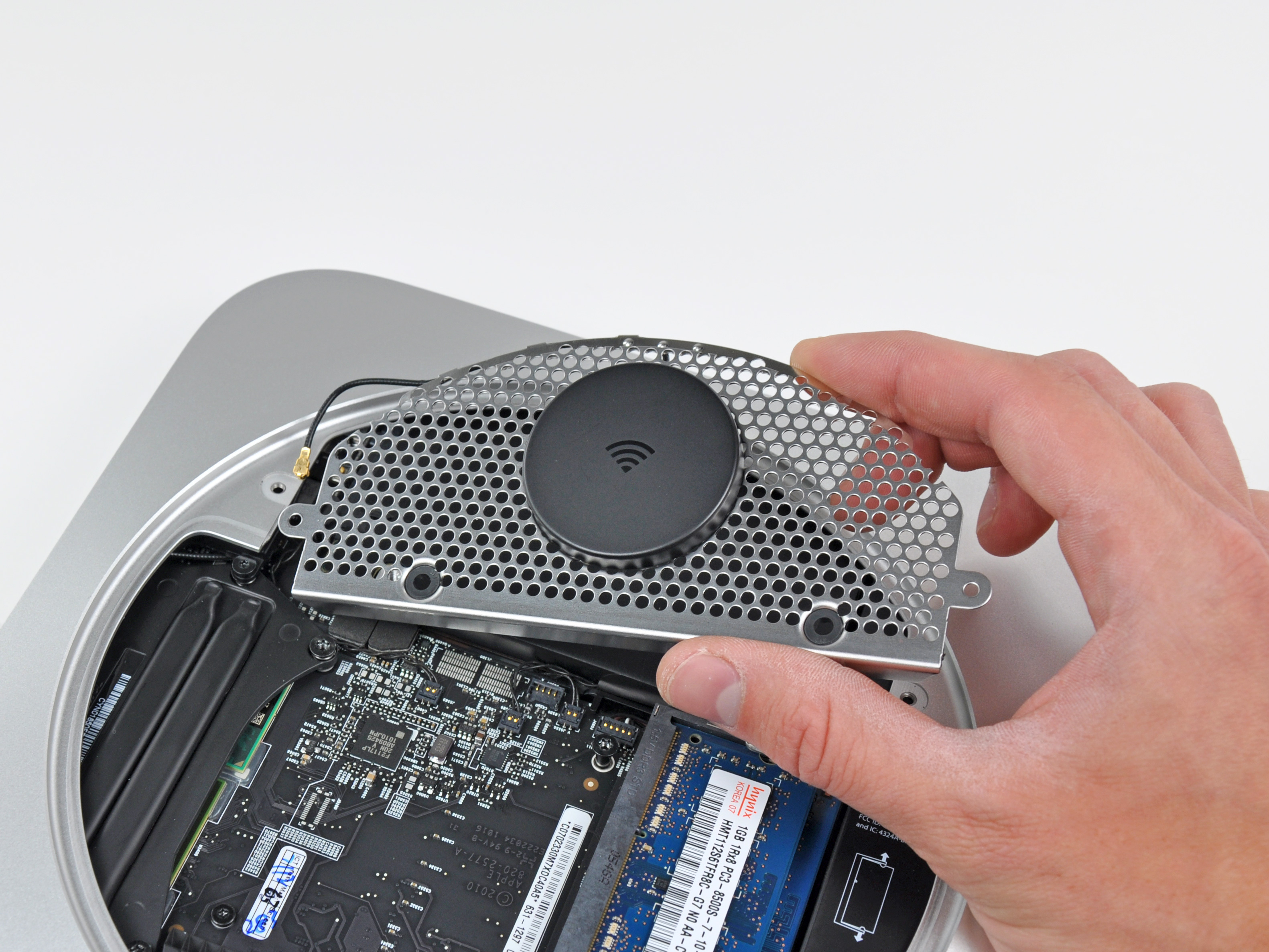

Use this guide to replace the antenna plate that serves as a mount for the antenna as well as the hard drive.

Add Note Edit Step 8 — Antenna Plate  ¶
  • Remove the following screws securing the antenna plate to the mini:
    • Two 6.6 mm T8 Torx screws
    • Two 5.0 mm T8 Torx or 2.0 mm Hex screws (either will work)
