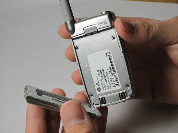

  • Turn off the cellphone by pressing down on the red "END" button for 3 seconds.
  • Flip cellphone over and press up on the gray sliding mechanism towards the top of the phone. At the same time, pull on the large silver battery and it should come right off.

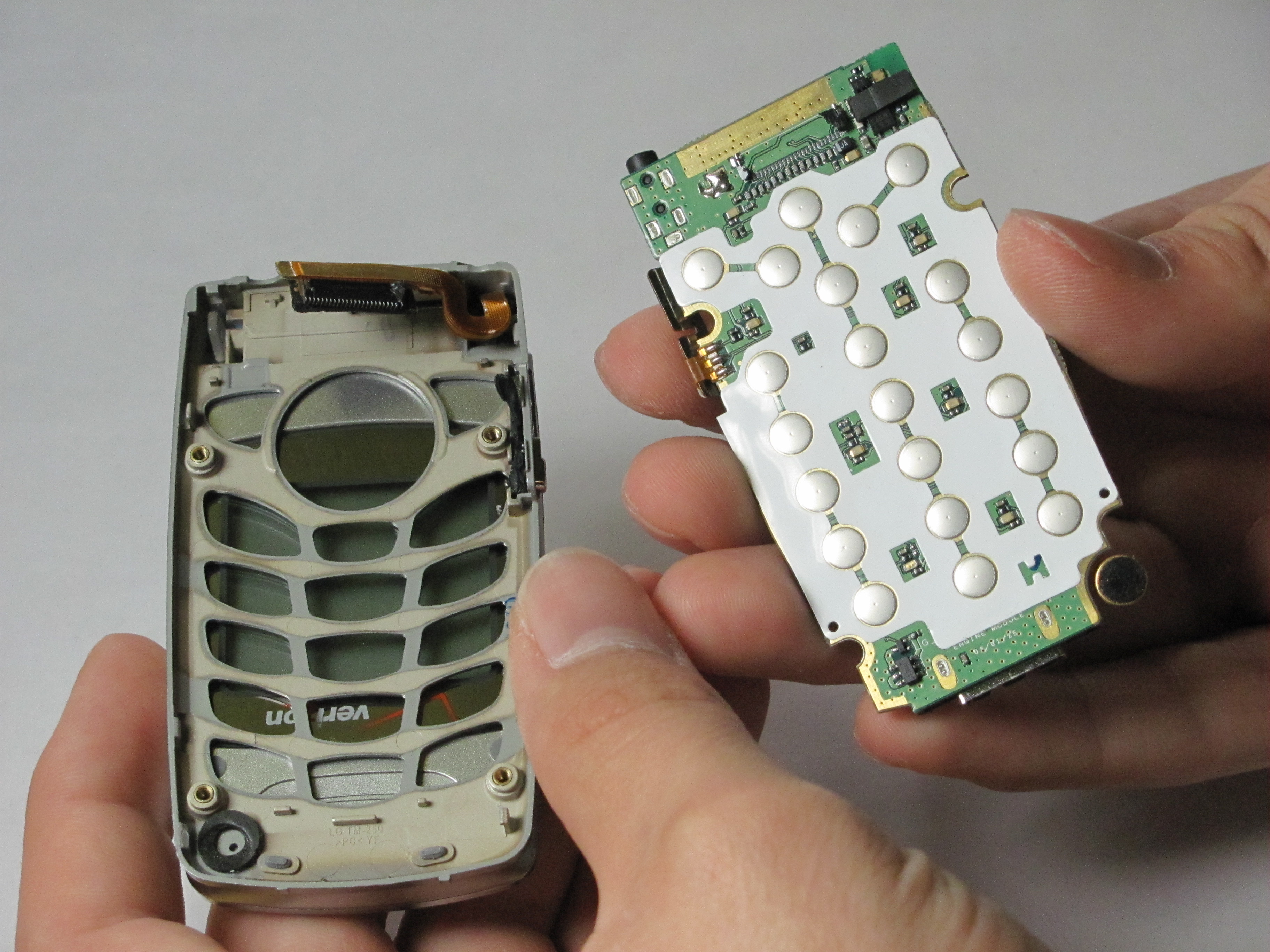

  • Gently pry off the logic board with the spudger; notice the gold strip that connects the logic board to the rest of the phone.
  • Prying the logic board off too quickly may damage the strip.
  • Desolder the part of the gold strip that is attached to the logic board.
  • Use the spudger to carefully lift up the small latch that holds the gold strip onto the logic board.
