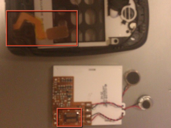

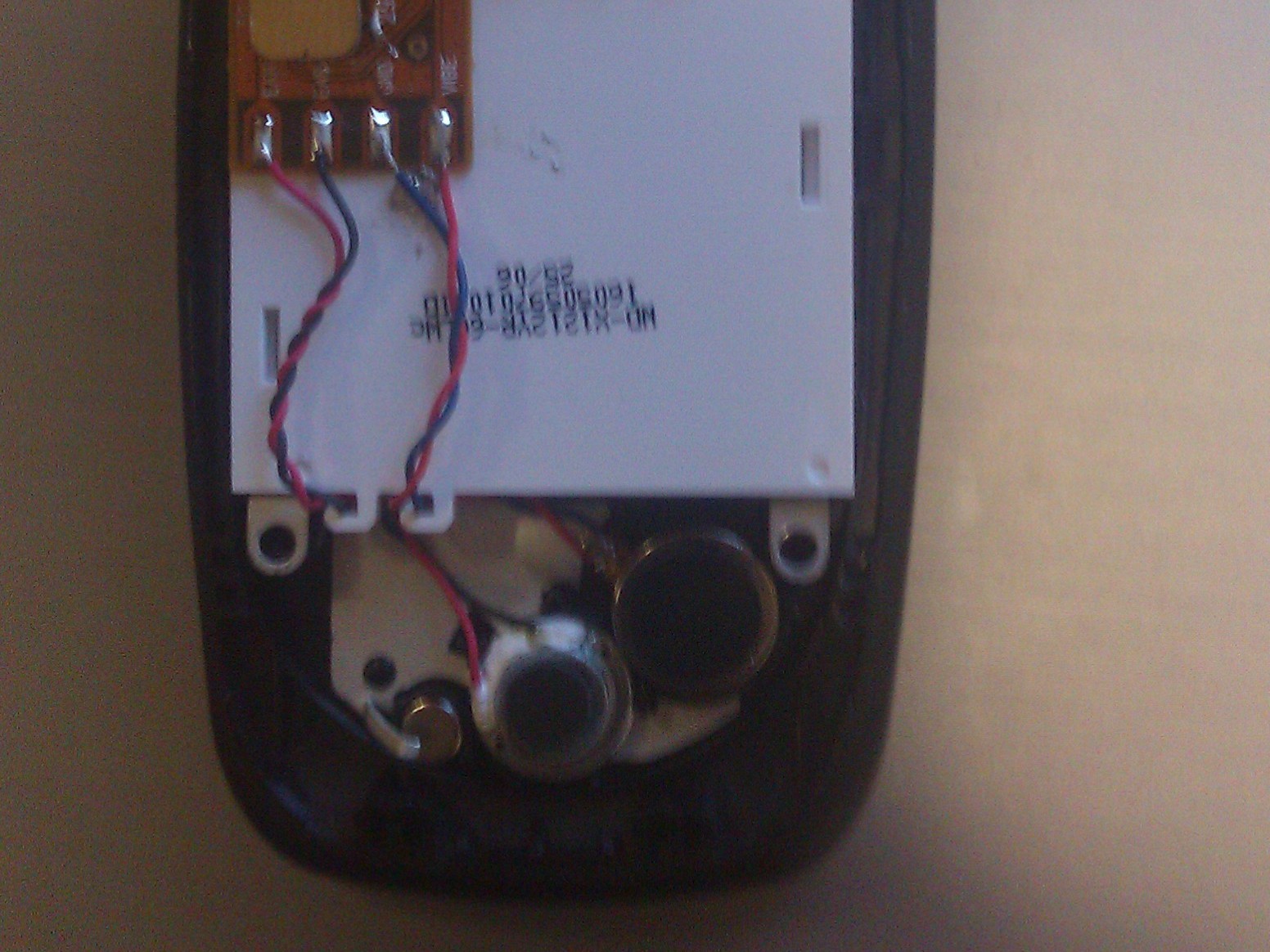

Common Kyocera Oyster problem, easy fix.
  • Author: David
  • Difficulty: Moderate
Providing information to disassemble the phone and replace the screen

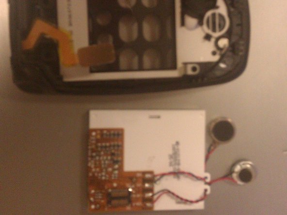

Image #1 Image #2
Add Note Edit Step 1 — Screen Replacement  ¶
  • Remove two black screws that hold the screen down
  • Pry out speakers with small flat head screwdriver (can be difficult)
  • Remove wire that comes from the motherboard to the screen
Image #1
Add Note Edit Step 2  ¶
  • Remove screen
  • Insert new screen
    • put speakers back in and reassemble
