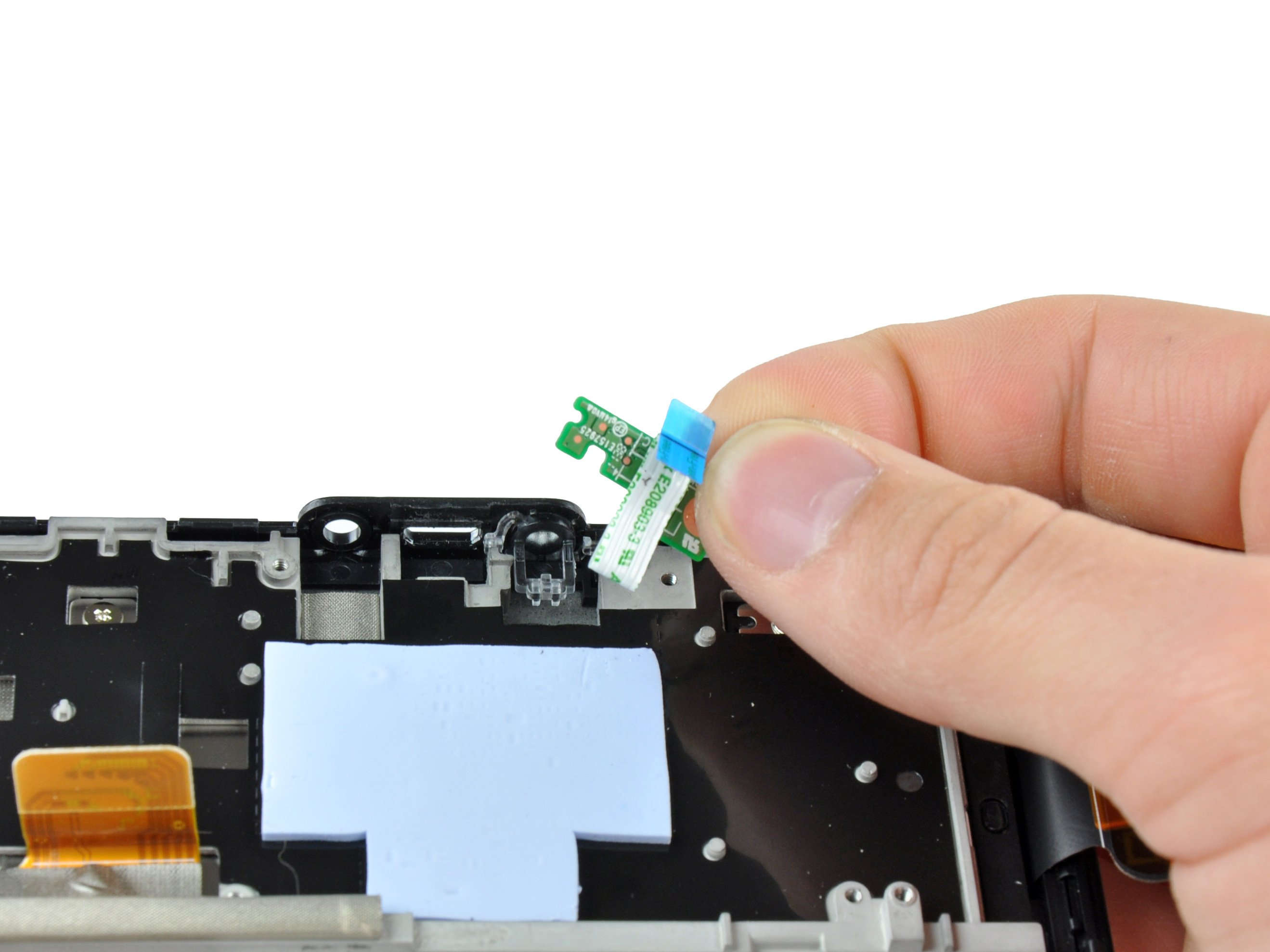

Add Note Edit Step 11 — Power Button Board  ¶
  • Remove the 2.5 mm Phillips #00 scew securing the power button board to the Kindle Fire.
  • Lift the power button board out of the Kindle Fire.
