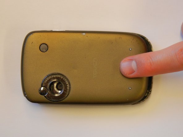

Add Note Edit Step 1 — Camera Lens  ¶

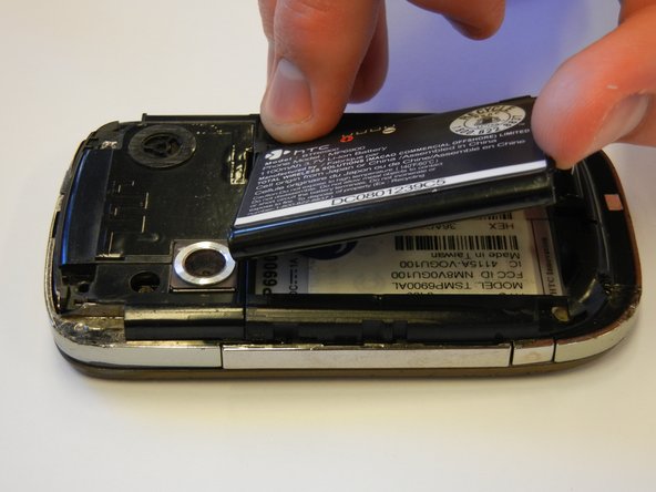

  • Remove the back panel by sliding it up.
Image #1
Add Note Edit Step 2  ¶
  • Remove the battery.
Image #1
Add Note Edit Step 3  ¶
  • Remove the 4 torx-head screws in the corners of the phone using the T5 Torx Screwdriver.
Image #1 Image #2

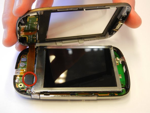

Add Note Edit Step 4  ¶
  • Use the plastic opening tool to remove the front panel from the phone.
  • Unplug the front button cable from the inside of the phone.
Image #1
Add Note Edit Step 5  ¶
  • Unscrew the torx-head screws at the base of the LCD screen using the T5 Torx Screwdriver.
Image #1 Image #2

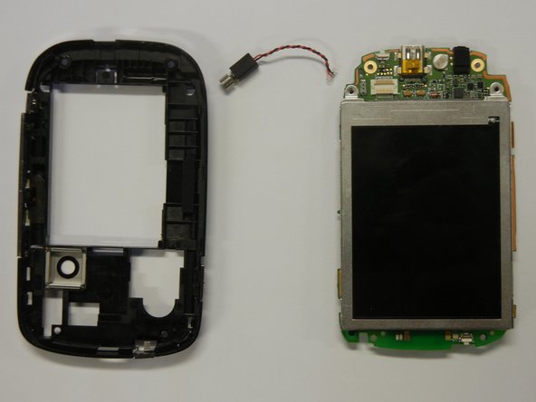

Add Note Edit Step 6  ¶
  • Seperate the motherboard from the black plastic casing.
  • Unplug the black and red wire from the motherboard.
  • Unplug the black and red wire from the black plastic casing.
Image #1

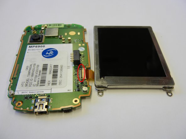

Add Note Edit Step 7  ¶
  • Lift the black lever next to the orange ribbon cable to remove the LCD Screen.
Image #1

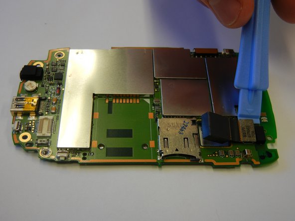

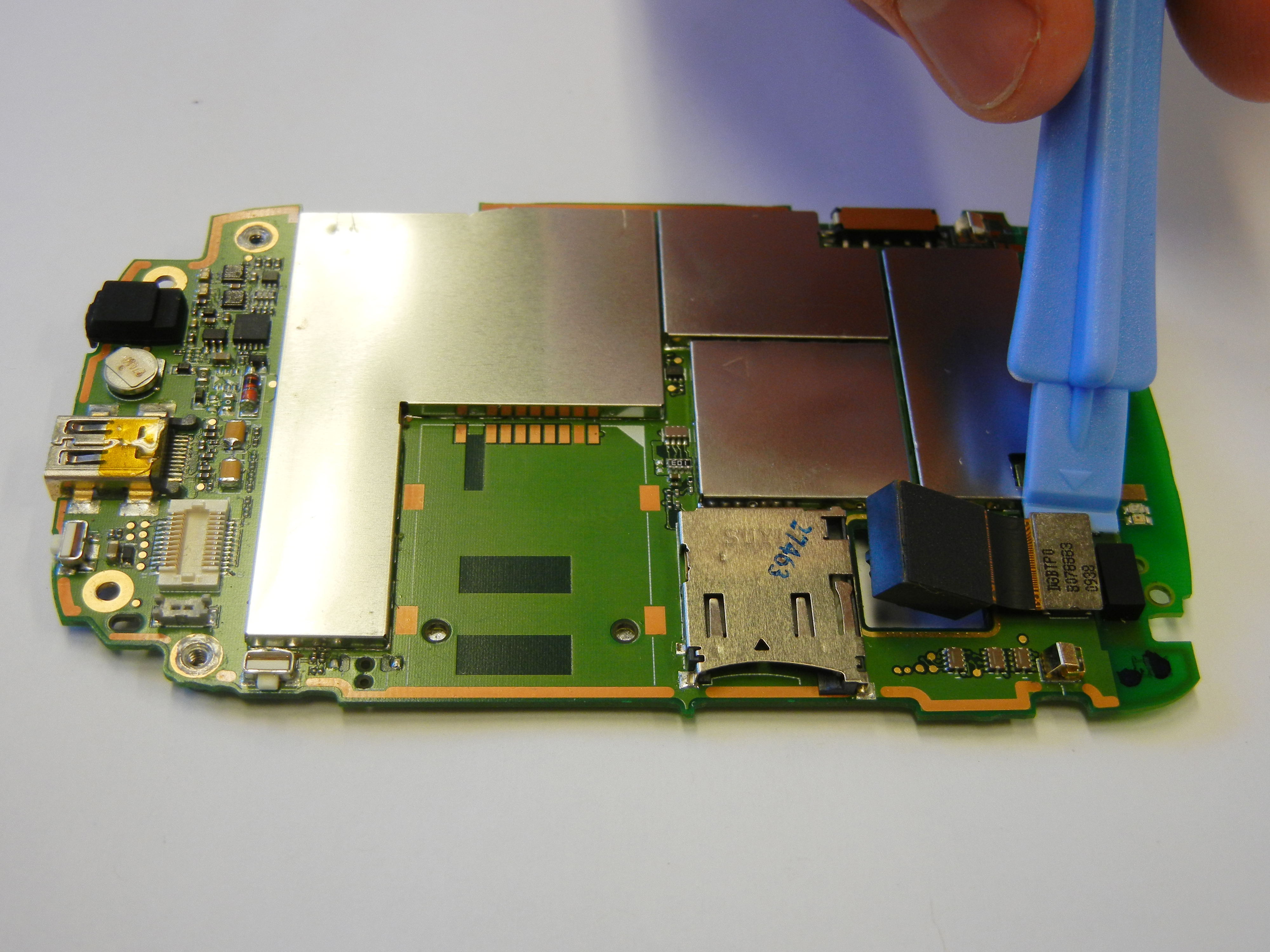

Add Note Edit Step 8  ¶
  • Remove the camera lens from the motherboard using the plastic opening tool.
