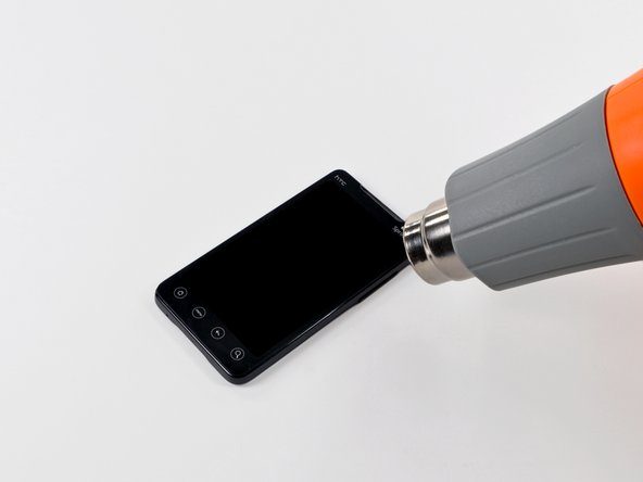

Add Note Edit Step 25  ¶
  • Use a heat gun to soften the adhesive along the right side of the front glass panel.
Image #1 Image #2 Image #3

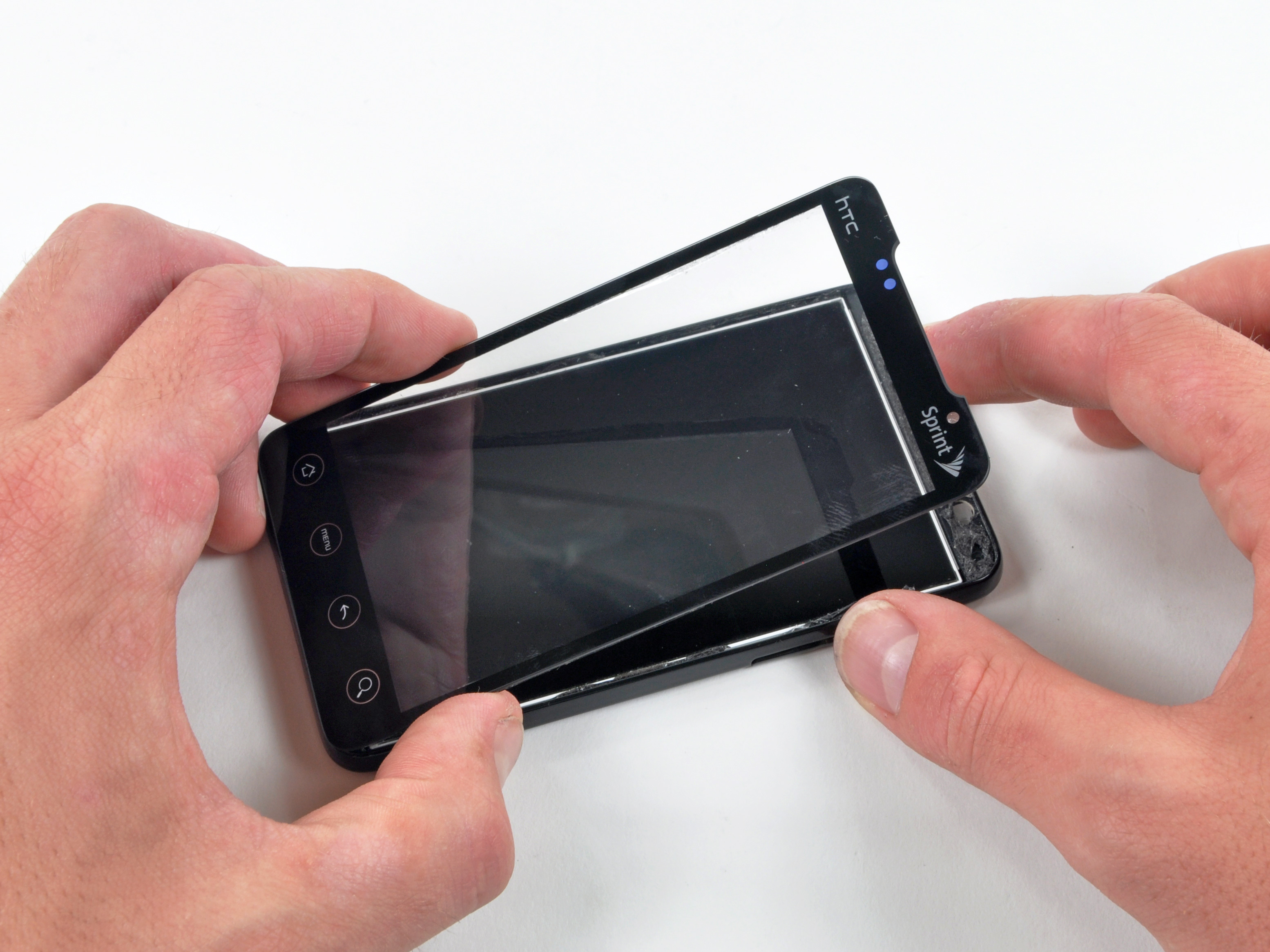

Add Note Edit Step 26  ¶
  • Pry up the front panel along the right edge using the method described in previous steps.
  • Eventually work around the entire perimeter of the front panel until it is lifted slightly from the inner case.
  • Don't try to completely remove the front panel just yet. Its ribbon cable is still attached to the inner case.
Image #1
Add Note Edit Step 27  ¶
  • Peel the front panel ribbon cable off the adhesive securing it to the metal underside of the inner case.
Image #1 Image #2
Add Note Edit Step 28  ¶
  • Lift the front panel out of the inner case, minding the cable still routed through the bottom of the Evo.
  • Carefully de-route the front panel ribbon cable through the slot in the inner case.
  • Remove the front panel.
  • Notice the four (4) clear plastic hooks that are adhered behind the menu buttons. Look closely. Each one is shaped differently and in a particular orientation.
  • If the replacement front panel does not have these installed already, carefully remove and transfer them from the old panel to the replacement.
