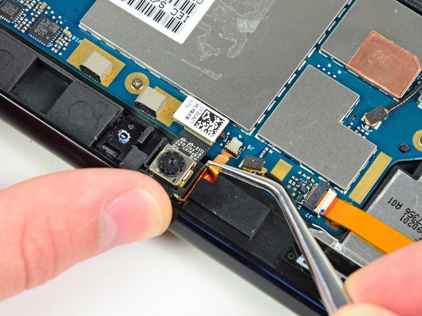

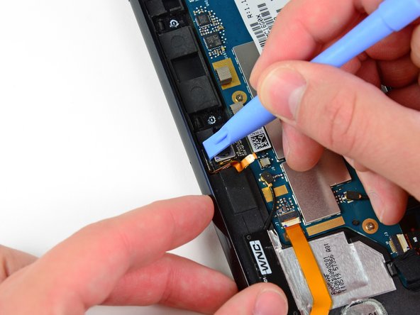

Add Note Edit Step 11 — Microphone  ¶
  • Use the edge of a plastic opening tool to flip up the microphone ribbon cable retaining flap.
  • Use a pair of tweezers to pull the microphone cable out of its socket.

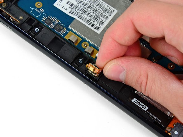

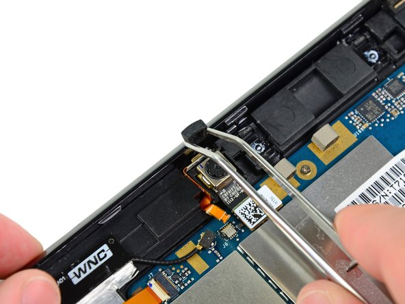

Add Note Edit Step 12  ¶
  • Use your tweezers to remove the black rubber grommet between the microphone and rear case.

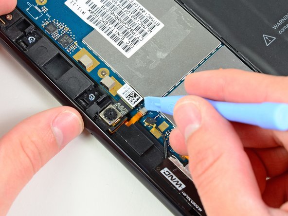

Add Note Edit Step 13  ¶
  • Use the edge of a plastic opening tool to pry the microphone away from the portion of the rear case right above the camera.

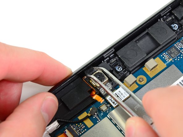

Add Note Edit Step 14  ¶
  • Remove the microphone.
