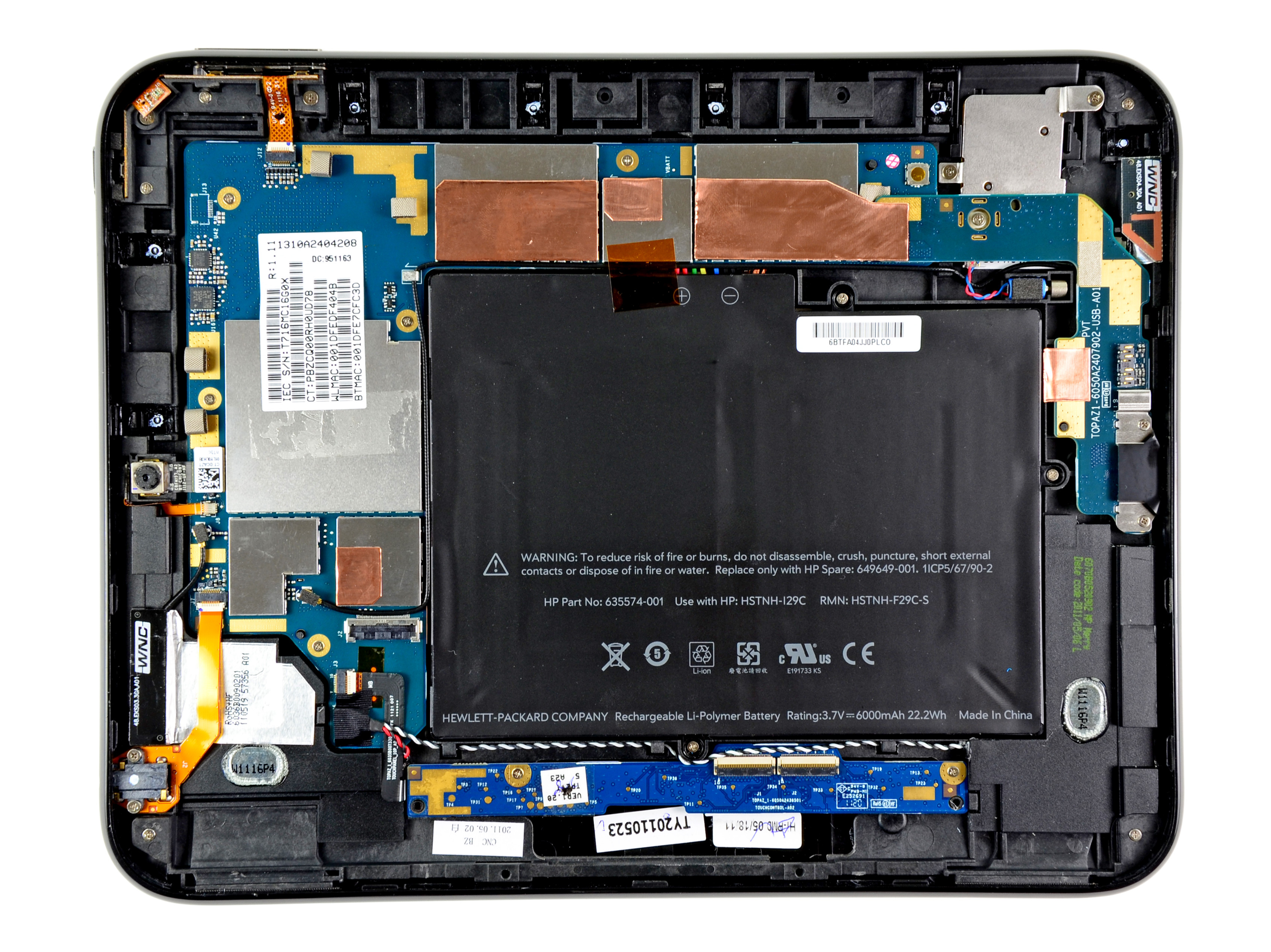

  • Use your fingernail to carefully flip up the retaining flaps on the two digitizer ribbon cable ZIF sockets.
  • Be sure you are prying up on the hinged retaining flaps, not the sockets themselves.
  • Pull the digitizer ribbon cable straight out of its two sockets on the motherboard.
Image #1
Add Note Edit Step 10  ¶
  • Remove the front panel assembly from the rear case assembly.
