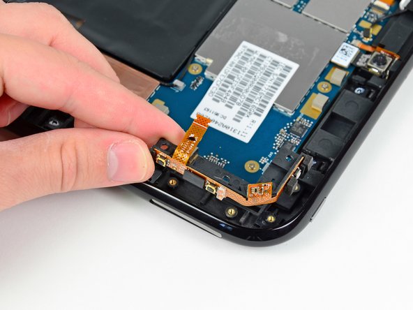

  11. HP TouchPad Control Button Assembly Replacement, Control Button Assembly: step 11, image 1 of 2 HP TouchPad Control Button Assembly Replacement, Control Button Assembly: step 11, image 2 of 2
    • Use the edge of a plastic opening tool to flip up the retaining flap on the control button cable ZIF socket.
    • Pull the control button ribbon cable straight out of its socket on the motherboard.
  12. HP TouchPad Control Button Assembly Replacement: step 12, image 1 of 1
    • Use the edge of a plastic opening tool to peel the ambient light sensor off the body of the control button assembly, revealing a hidden screw.
  13. HP TouchPad Control Button Assembly Replacement: step 13, image 1 of 1
    • Remove the following four screws securing the control button assembly to the rear case:
    • Two 3.1 mm Phillips screws
    • Two 2.7 mm Phillips screws
  14. HP TouchPad Control Button Assembly Replacement: step 14, image 1 of 2 HP TouchPad Control Button Assembly Replacement: step 14, image 2 of 2
    • Use the edge of a plastic opening tool to lift the control button assembly up from its housing in the rear case.
    • Remove the control button assembly from the TouchPad.
