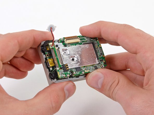

Add Note Edit Step 9 — Motherboard Assembly  ¶
  • Remove the three screws securing the motherboard assembly to the front case:
    • Two 10.8 mm Phillips #00 screws.
    • One 4.8 mm Phillips #00 screw.
Image #1 Image #2

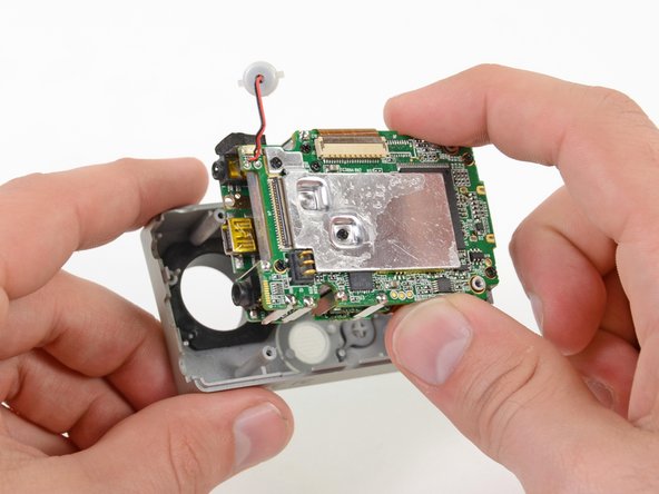

Add Note Edit Step 10  ¶
  • Gently grab the edges of the motherboard assembly and lift it out of the front case.

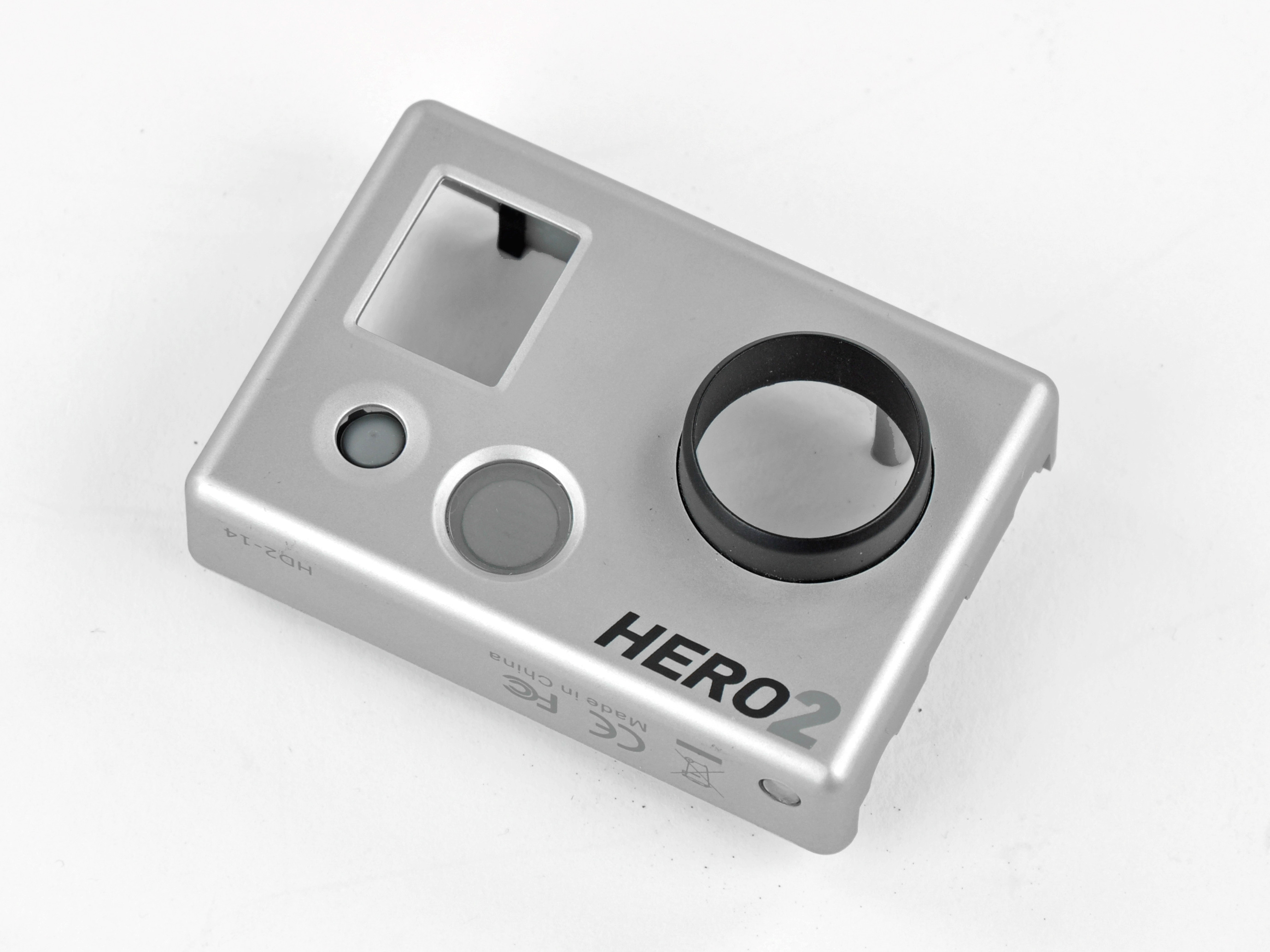

Add Note Edit Step 11 — Front Case  ¶
  • The front case remains.
