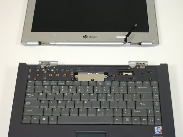

Removal of LCD display.
Image #1
  • Flip the laptop over. Slide the battery release tab to the right.
Image #1
Add Note Edit Step 2  ¶
  • Lift the battery out.
Image #1
Add Note Edit Step 3 — Power button panel  ¶
  • Insert spudger between sysrq and ins keys.
  • Gently lift power button panel from the right to left.
Image #1

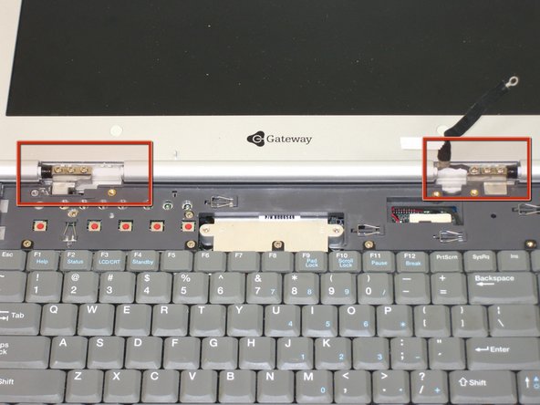

Add Note Edit Step 4 — LCD Display  ¶
  • Remove 5 screws.
  • 4 screws holding LCD hinge covers in place and 1 screw for LCD grounding.
  • Remove hinge covers.
Image #1

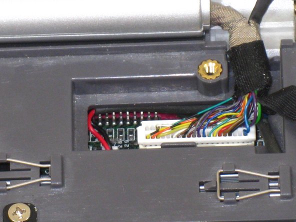

Add Note Edit Step 5  ¶
  • Gently unplug LCD from system board.
Image #1
Add Note Edit Step 6  ¶
  • Remove 6 screws holding LCD to hinge.
Image #1
Add Note Edit Step 7  ¶
  • Pull LCD away from case.
