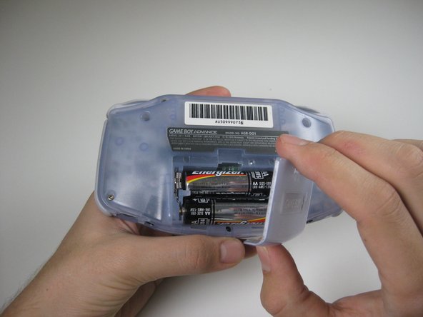

  • Take the battery cover off by releasing the locking tab and hinging the cover away.

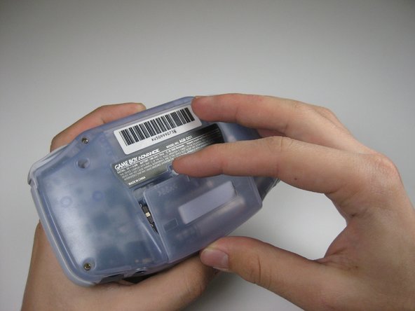

  • Remove the six back panel screws using a Tri-wing Screwdriver.

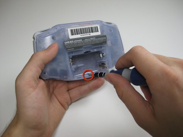

  • Remove bottom back panel screw with a Phillips #1 screw driver.

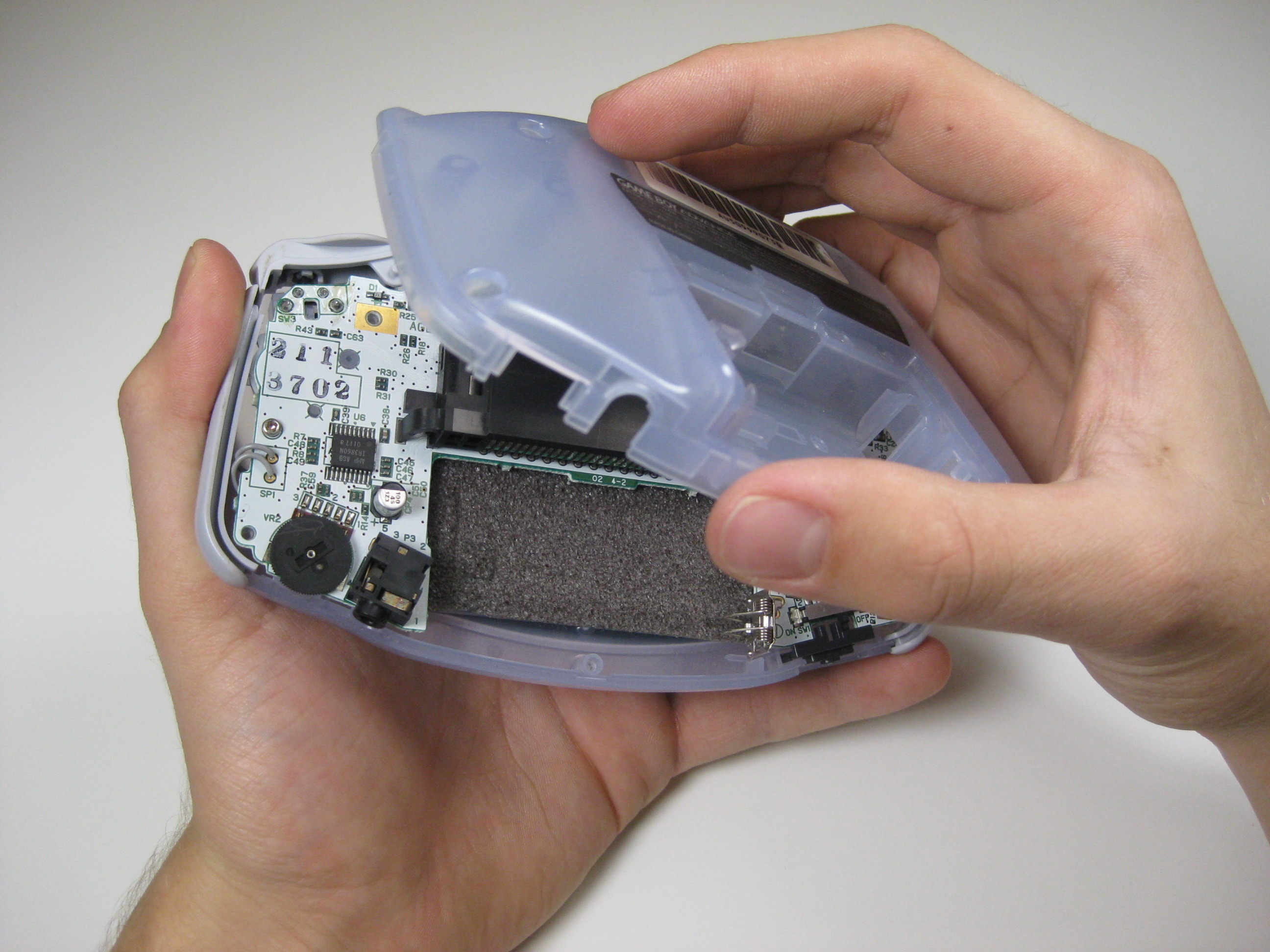

  • Remove the back panel by pulling away with one hand and the front secured in the other hand.
  • Removal of the back panel may cause shoulder buttons and side panels to come loose and fall off.
