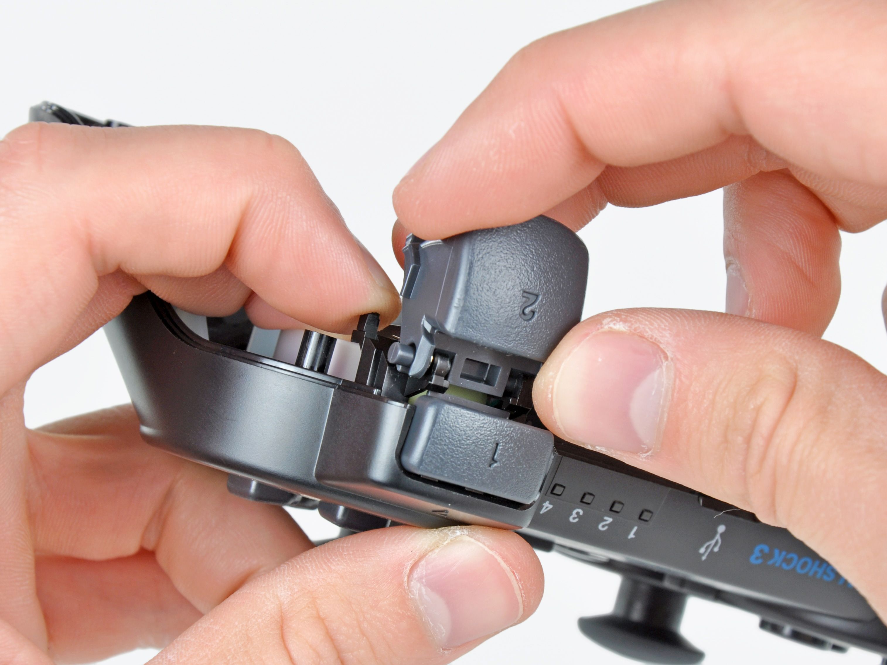

Add Note Edit Step 4 — Trigger Buttons  ¶
  • While holding the black plastic trigger retainer with one hand, pull the #2 trigger off of its axle.
Image #1 Image #2
Add Note Edit Step 5  ¶
  • When reinstalling the #2 trigger, be sure the spring is positioned as shown before popping the axle back into place.
Image #1 Image #2
