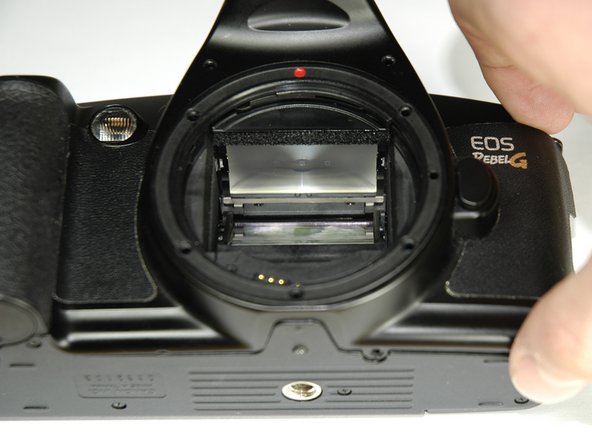

  • Using a #00 Phillips screw driver, remove three 4.4 mm Phillips screws as indicated by the red circles.
Image #1 Image #2

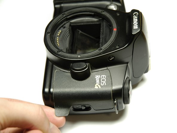

Add Note Edit Step 2  ¶
  • Using your finger, peel back the textured grip so the components are separated.
Image #1 Image #2 Image #3

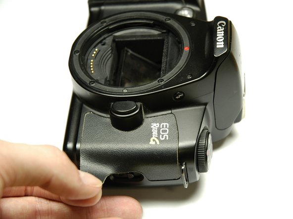

Add Note Edit Step 3  ¶

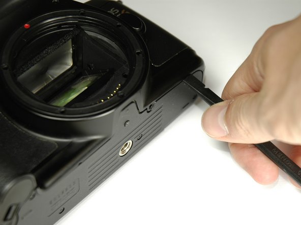

  • Using the flat end of a spudger, loosen the connection between the front panel and the device.
  • Remove the front panel using your hands.
Image #1

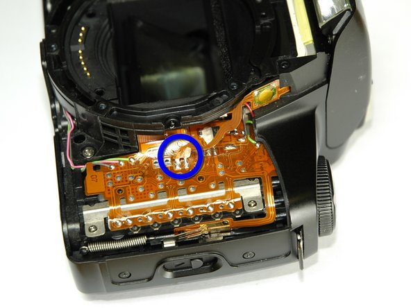

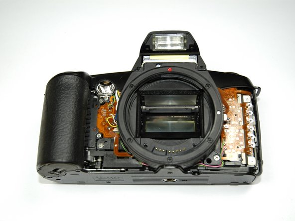

Add Note Edit Step 6  ¶
  • Lay the camera on its back.
  • Unsolder the flash connection from the motherboard as noted by the blue circle.

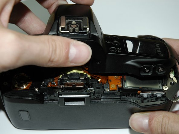

Add Note Edit Step 7  ¶

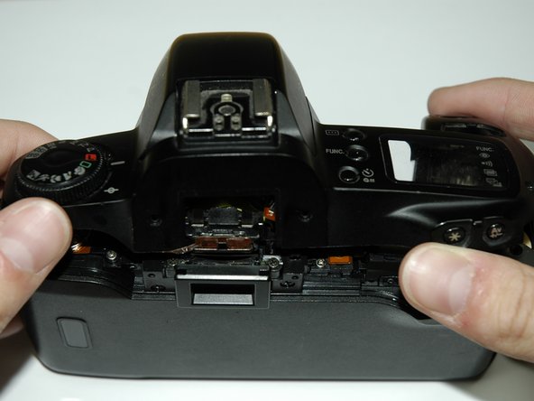

  • Remove the top panel by lifting it from the back, pushing it forward over the camera and letting it rotate down in front of the camera.
Image #1

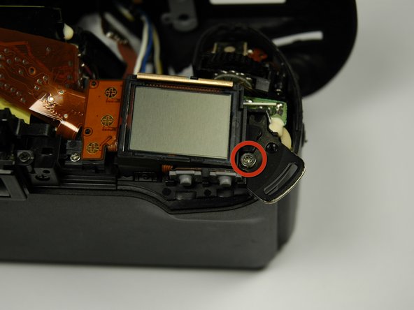

Add Note Edit Step 8 — Strap Anchors  ¶

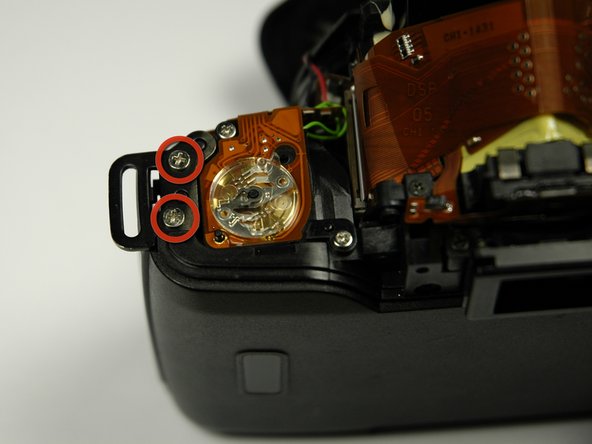

  • Unscrew the 6.8 Phillips screw that holds the strap anchor by the LCD.
Image #1

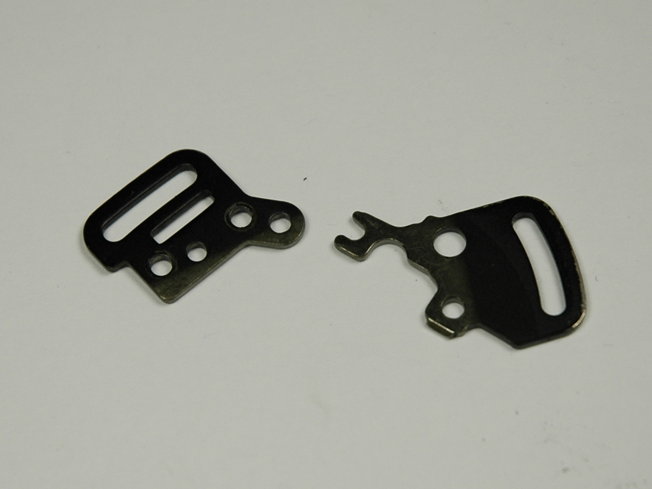

Add Note Edit Step 9  ¶
  • Unscrew the screws that hold the remaining strap anchor.
    • Two 4.9 mm Phillips screws
