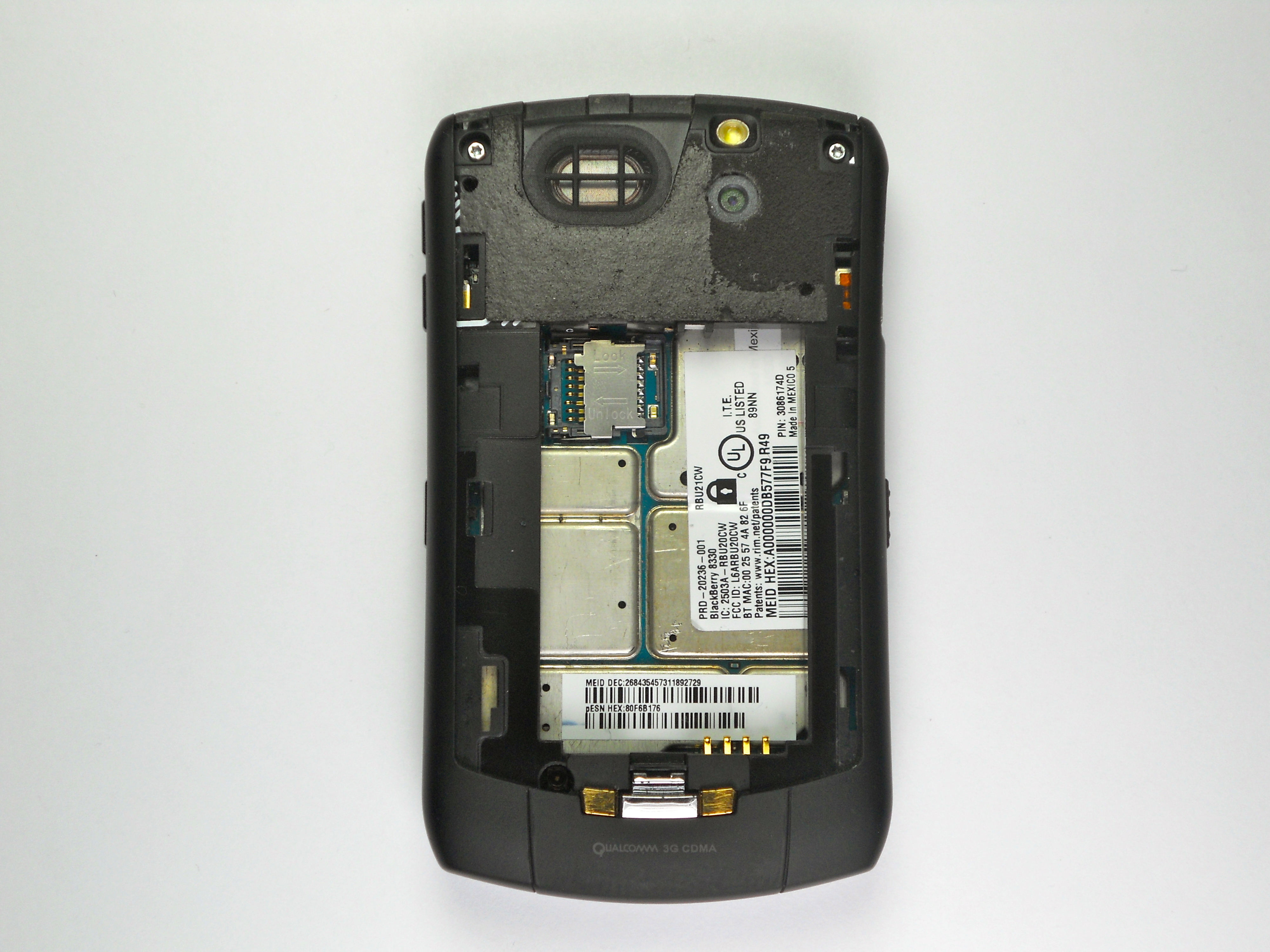

  • We did not have an actual back cover or battery for the phone we were given. Therefore, the first couple of steps will be without pictures.
  • Hold the phone with the back side facing you.
  • Press down on the silver tab towards the bottom end of the phone.
  • Carefully lift up the back casing to reveal the battery.
Image #1
Add Note Edit Step 2 — Remove Battery  ¶
  • Put your finger on the top left corner of the battery and lift the battery up and out of its housing.
  • The phone should now look like this.
