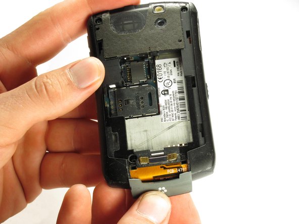

  • Hold the phone with the back facing you.
  • Press the silver tab down and remove the cover.

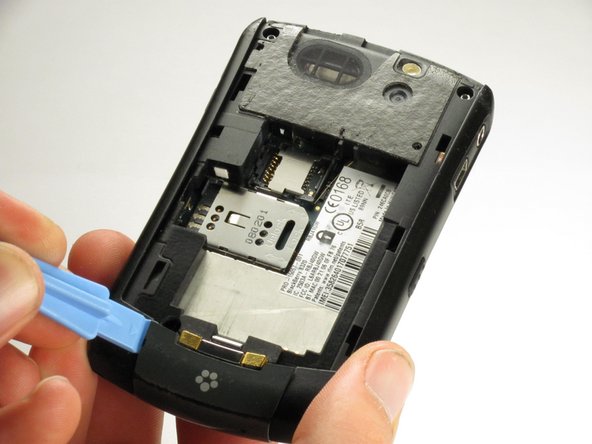

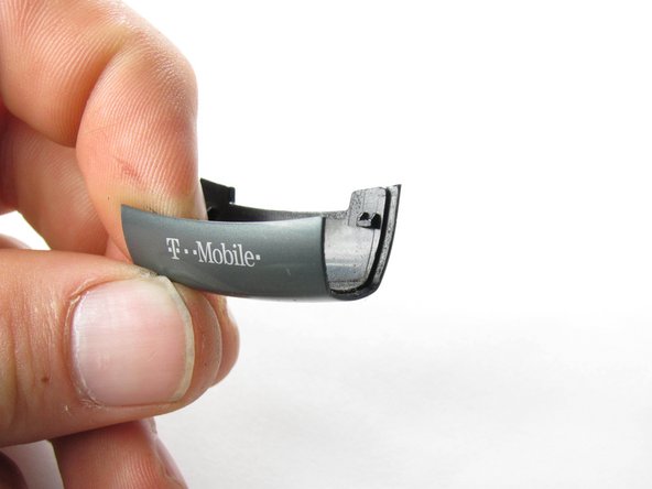

Add Note Edit Step 3 — Front Panel  ¶
  • Use a plastic opening tool to gently pry the bottom cover loose.
  • Do not use excessive force at risk of damaging the antenna, which is under this casing.
  • Pull the cover from the front of the phone after the back is loose.
Image #1 Image #2

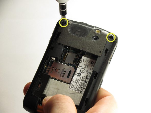

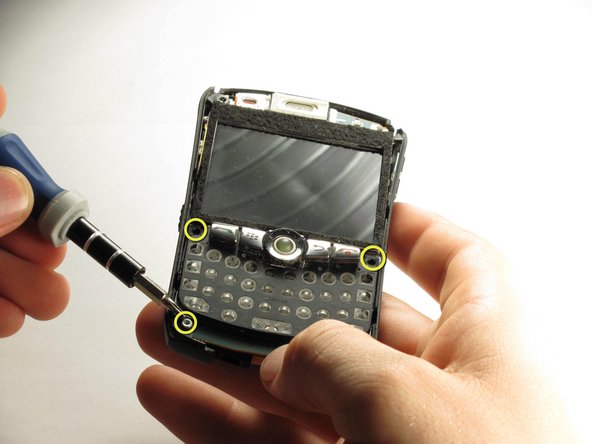

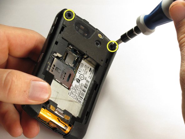

Add Note Edit Step 4  ¶
  • Remove the two top screws with a T5 Torx screwdriver.
  • The screws are 8mm long.
Image #1 Image #2

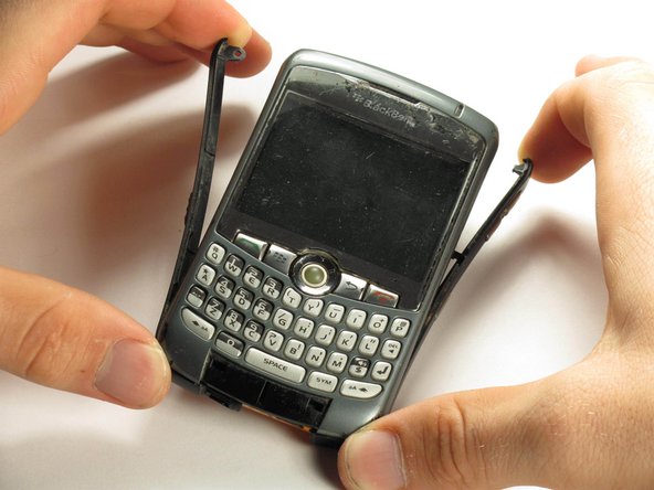

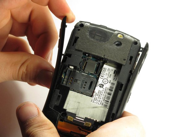

Add Note Edit Step 5  ¶
  • Gently pry off the top of the side casings.
  • The side casings cannot be fully removed yet because they are screwed on at the bottom.
Image #1

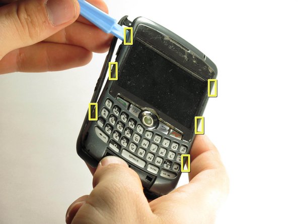

Add Note Edit Step 6  ¶
  • Use a plastic opening tool to detach the securing clips holding the the front panel in place.
  • There are six securing clips total.
Image #1

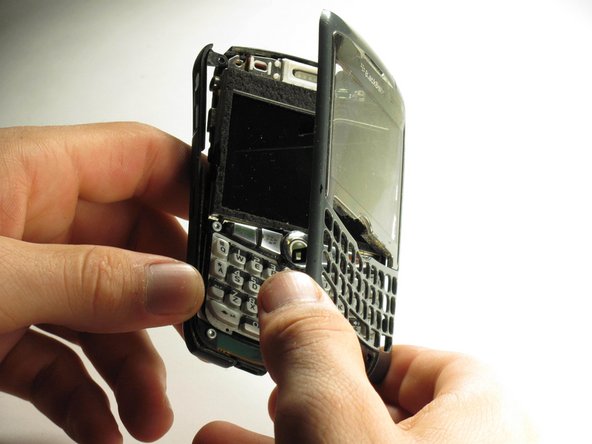

Add Note Edit Step 7  ¶
  • Remove the front panel.
  • You may need to apply some force because the front panel is attached to the rest of the device with adhesive.
Image #1 Image #2 Image #3

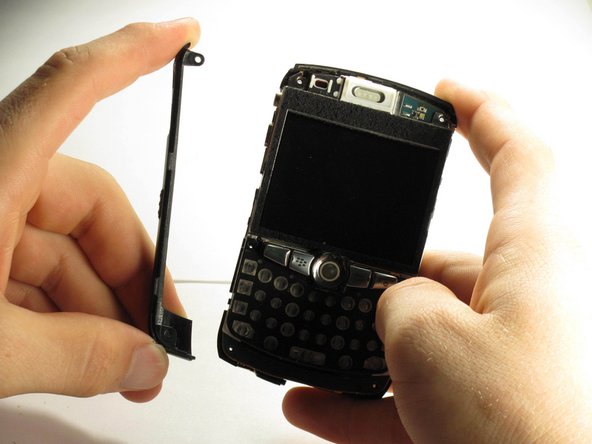

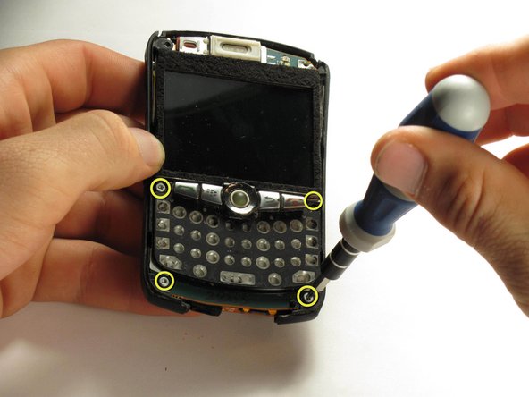

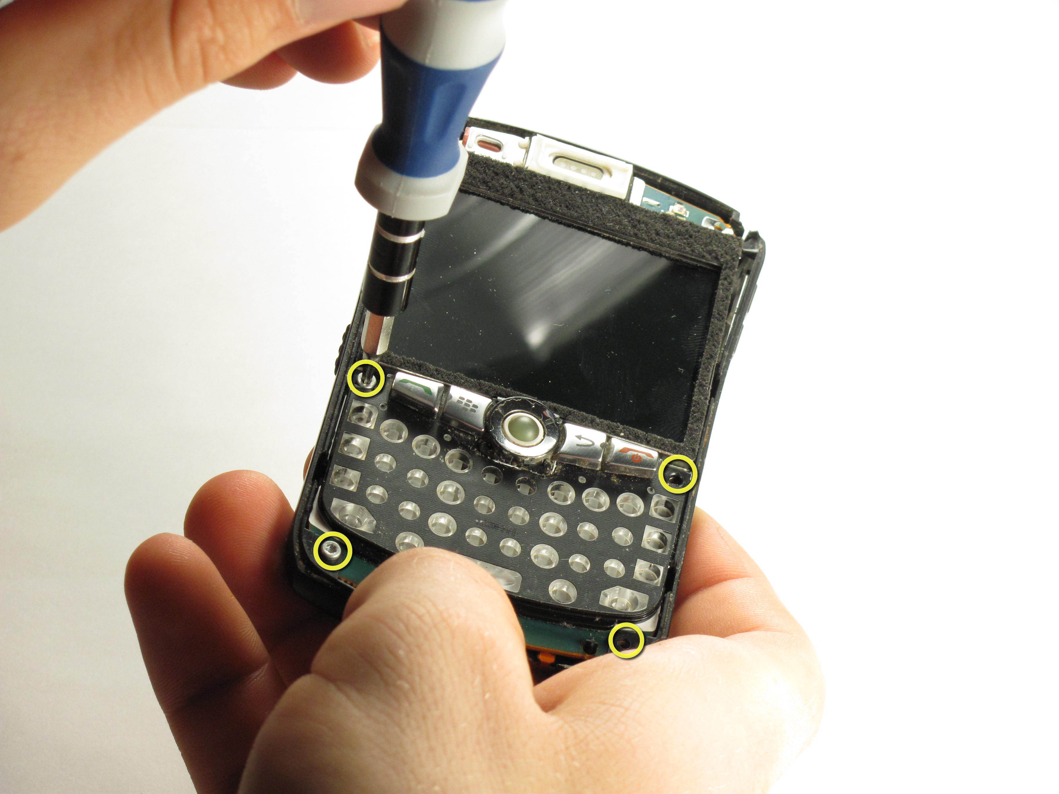

Add Note Edit Step 8 — Speaker  ¶
  • Use a T6 Torx screwdriver to remove the four screws located on the corners of the keyboard frame.
  • The screws are 6mm long.
Image #1 Image #2
Add Note Edit Step 9  ¶
  • After the bottom two screws have been removed the side casings can be removed.

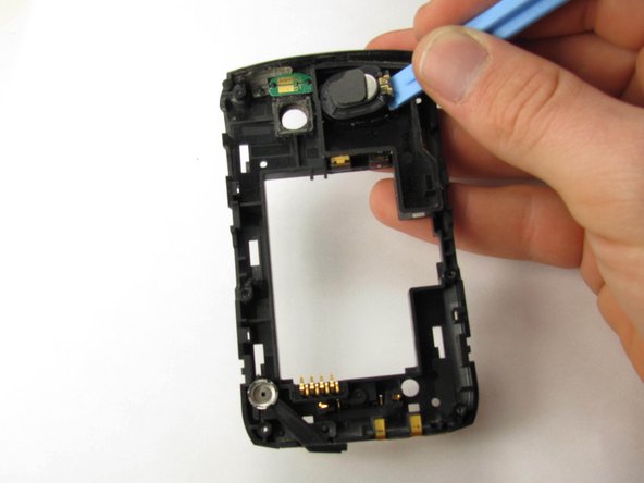

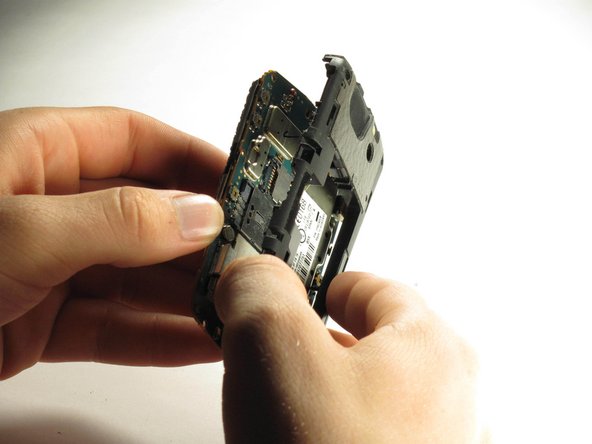

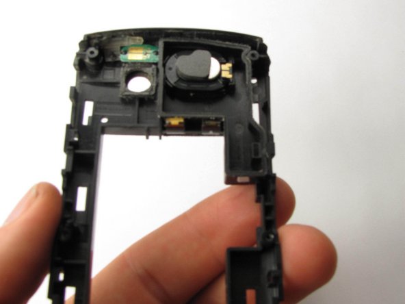

Add Note Edit Step 10  ¶
  • Remove the back case.
  • The speaker is located on the back case.
