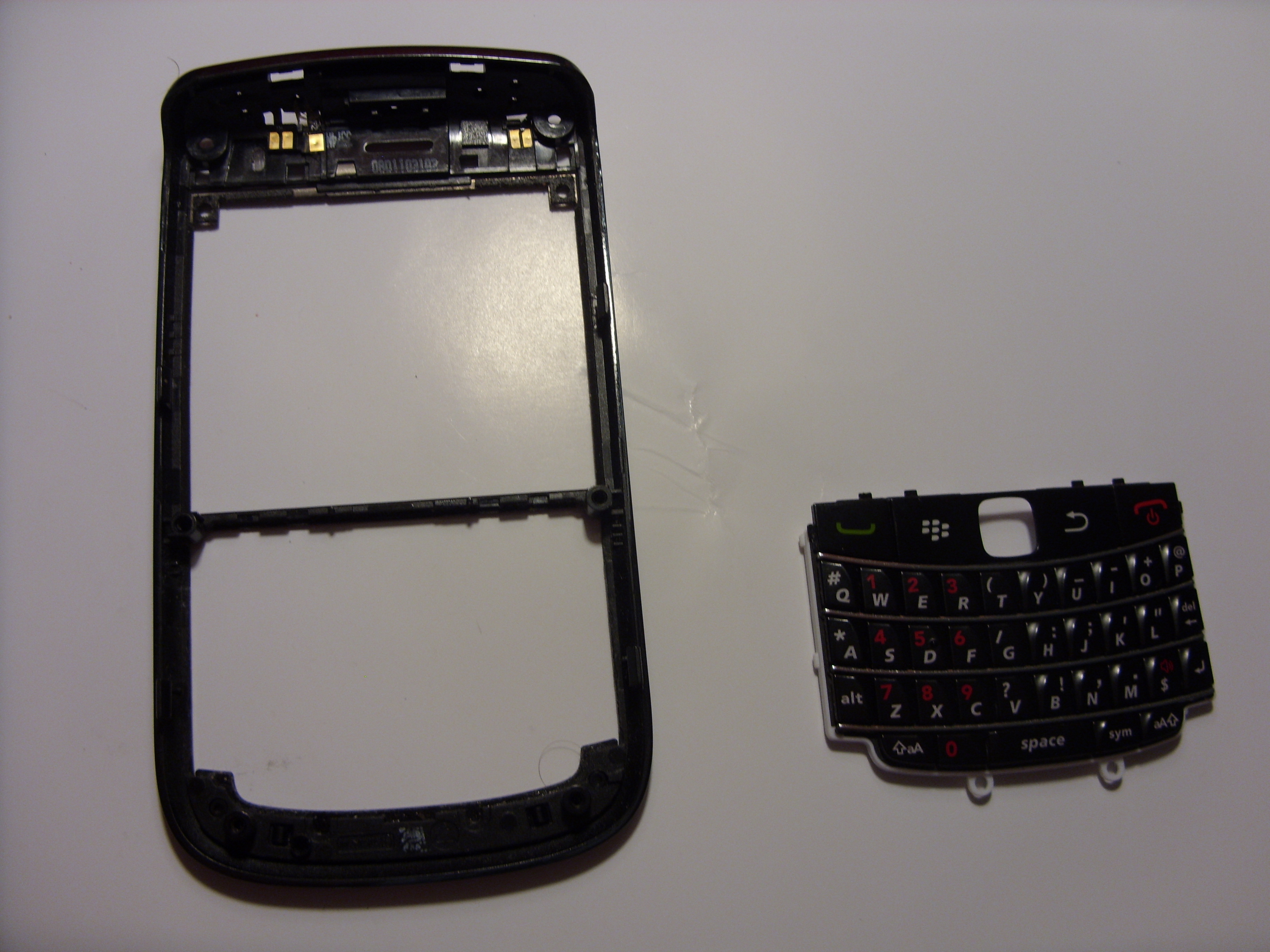

  • Using a T6 torx screwdriver remove the 4 torx screws on the back.
  • All the screws in the device are identical so they are are all interchangeable.
Image #1
Add Note Edit Step 6  ¶
  • Turn the phone over. Using a pry tool, remove the ear piece cover.
Image #1
Add Note Edit Step 7  ¶
  • Remove the two torx srews.
Image #1
Add Note Edit Step 8  ¶
  • Remove the rear chassis by wiggling it back and forth.
  • Be careful around the headphone jack as it can break if pulled too forcefully.
