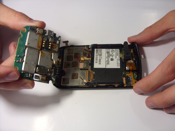

  • Lift the logicboard with your fingers.
  • Be careful when lifting the logicboard as the connectors underneath are delicate.
Image #1
Add Note Edit Step 11  ¶
  • Use tweezers to remove the three ribbon connectors.
  • Remember that the ribbon cable connectors are delicate.
Image #1
Add Note Edit Step 12  ¶
  • Lift the logic board out using an upward moving motion.
Image #1 Image #2

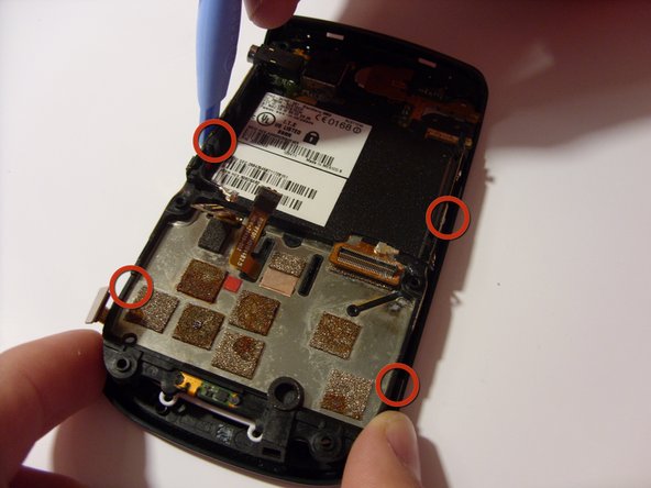

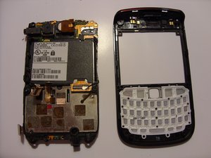

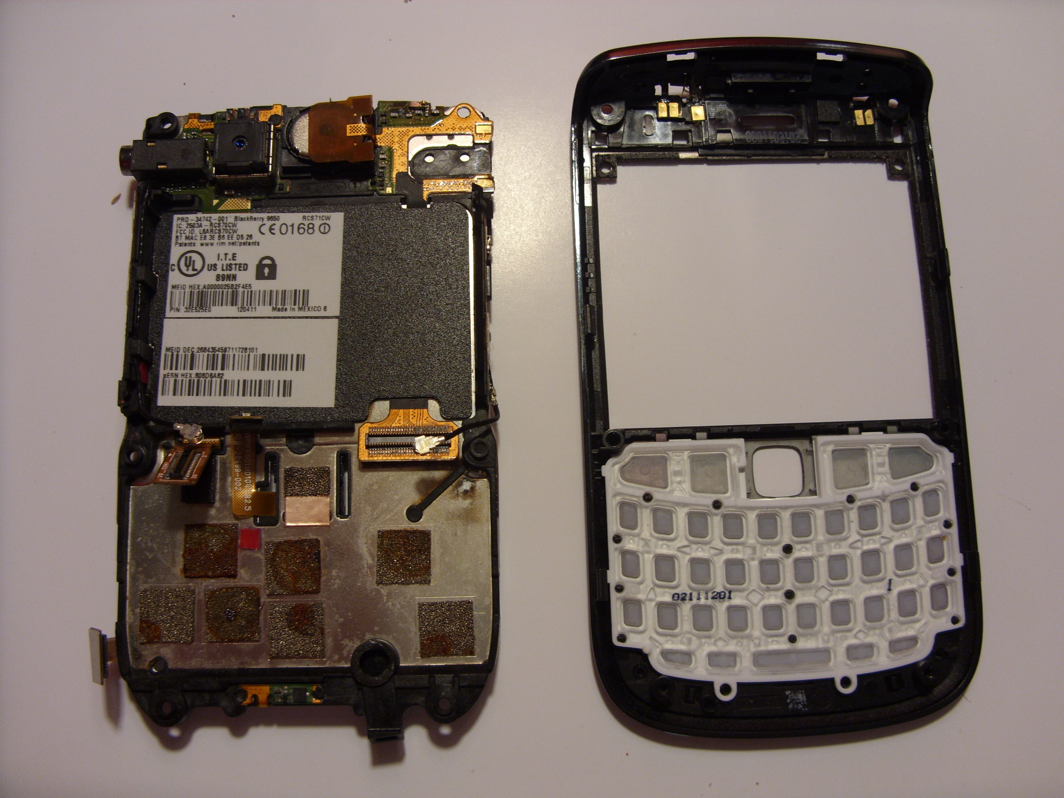

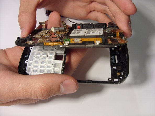

Add Note Edit Step 13 — Faceplate  ¶
  • Insert pry tool and lift up on the four highlighted tabs.
  • Lift the faceplate off in an upward motion.
