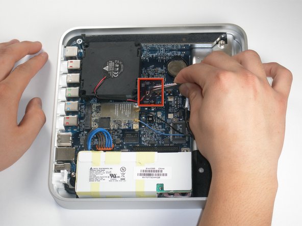

Add Note Edit Step 6  ¶
  • Using a pair of tweezers, pull the fan connector straight up from its socket on the logic board.
  • Lift and remove the fan out of the upper case.
Image #1

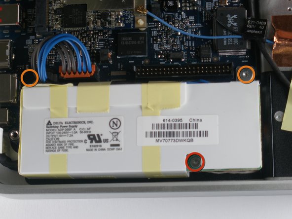

Add Note Edit Step 11  ¶
  • Remove the following three screws securing the power supply to the upper case:
    • One 4.8 mm T8 Torx screw
    • Two 5.8 mm T8 Torx screws
Image #1 Image #2

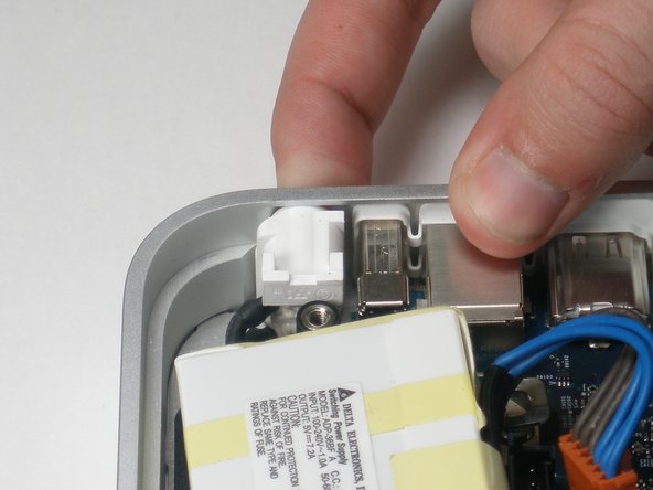

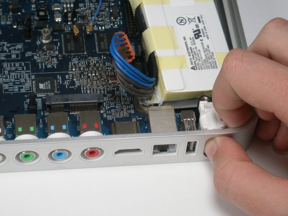

Add Note Edit Step 12  ¶
  • Use your finger to push and dislodge the AC power connector inwards, towards the power supply.
  • This should pop out easily.
Image #1

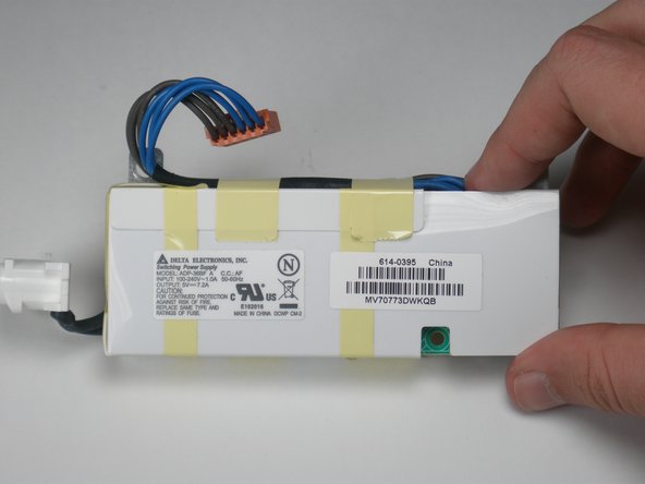

Add Note Edit Step 13  ¶
  • Power supply remains.
Image #1

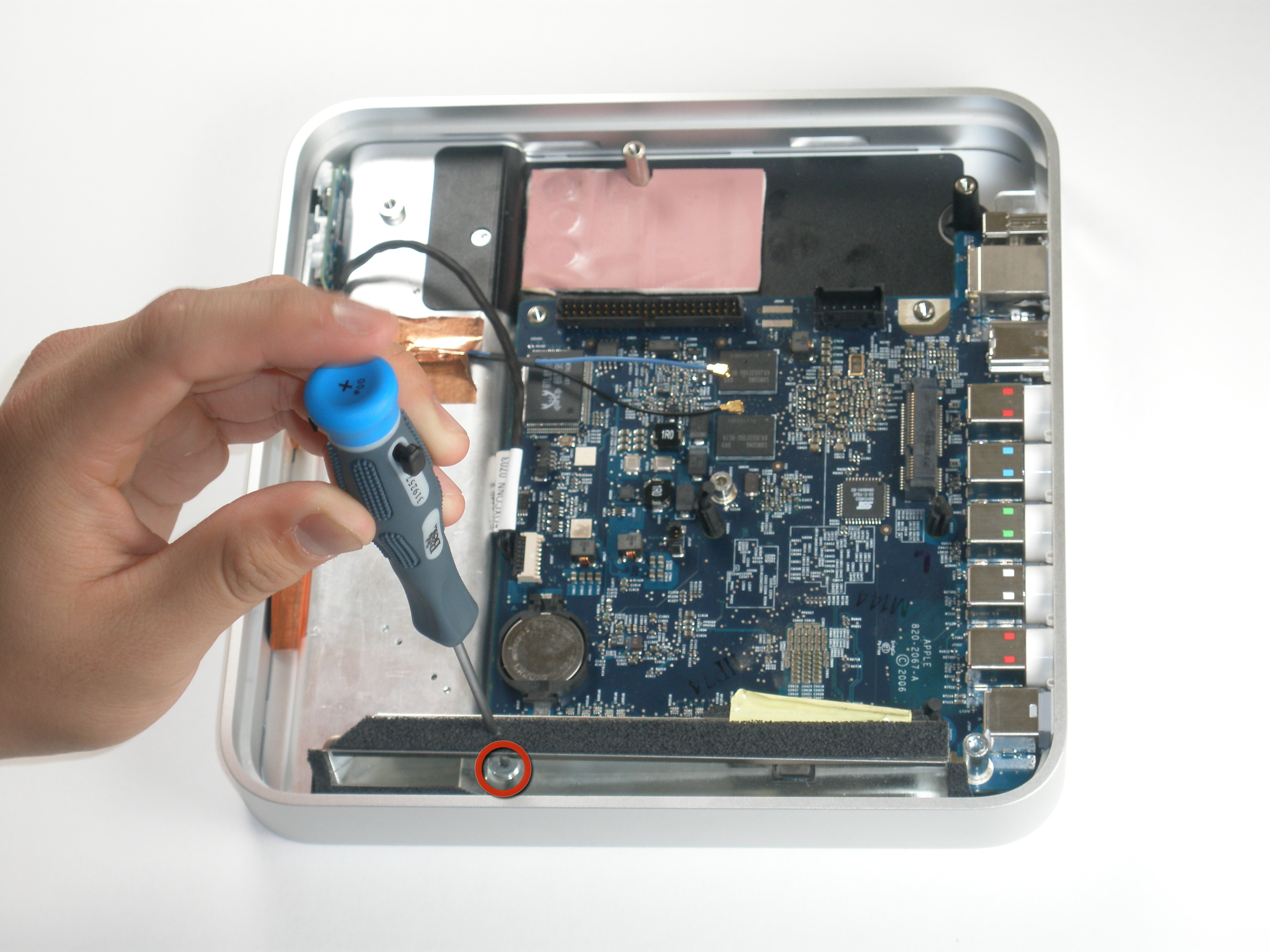

Add Note Edit Step 14 — Logic Board  ¶
  • Remove the T8 Torx screw securing the metal shield to the case.
  • In order to remove the T8 screw, you must insert the screwdriver through the access hole in the metal shield, located near the PRAM battery.
Image #1 Image #2
