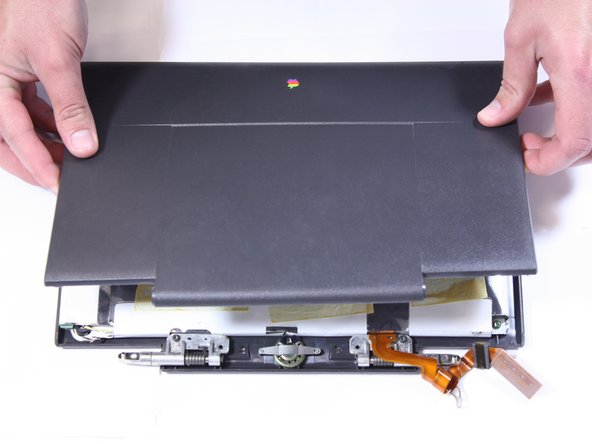

  • Use a wedge tool to pry open the two halves of the monitor assembly. Lift the top half away from the bottom half.
Image #1 Image #2 Image #3
