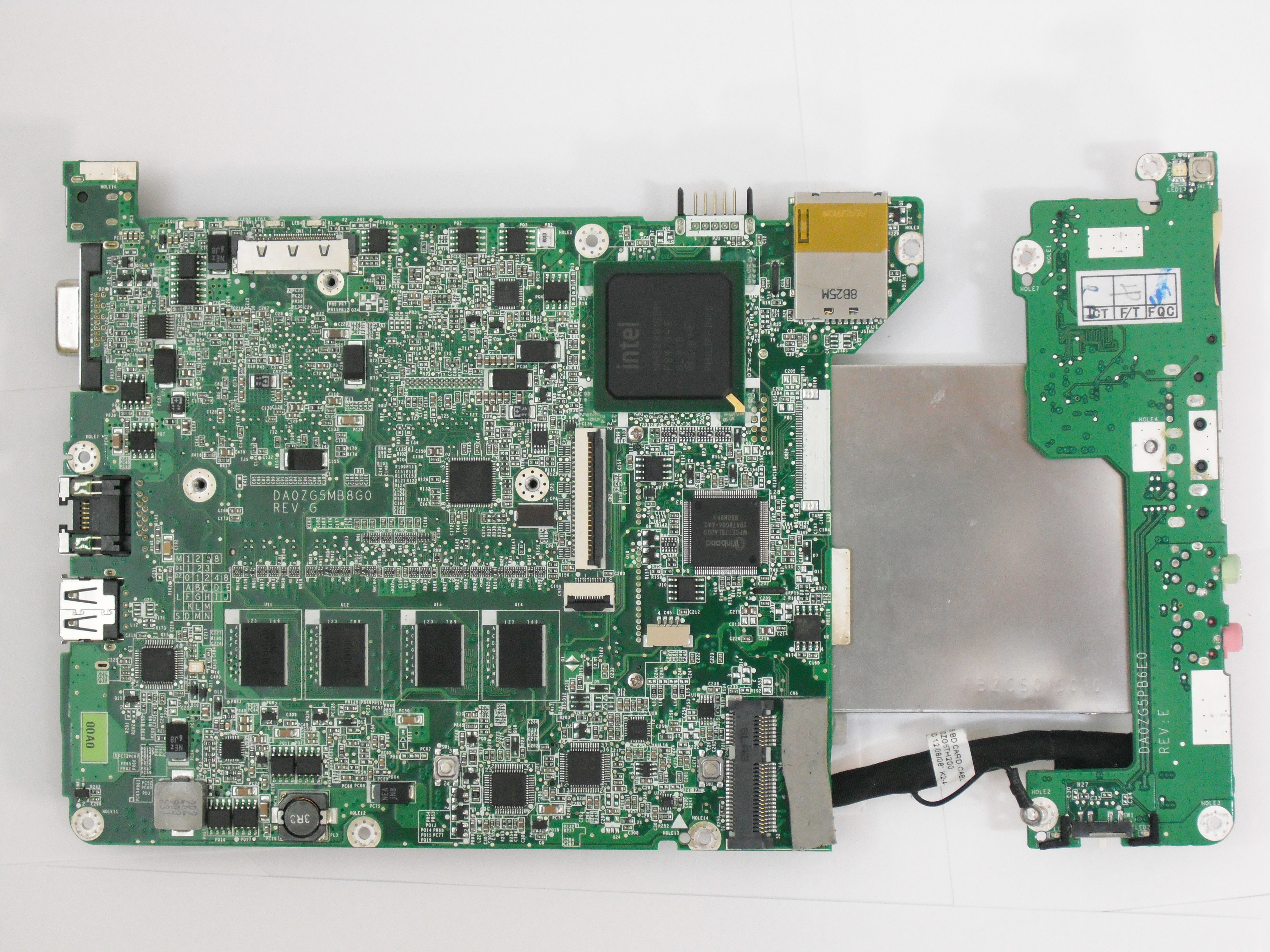

This guide will show you how to install a new motherboard.
  • Author: Doug Gallatin
  • Time required: 20 minutes
  • Difficulty: Moderate
  • Add Note x
  • x 13
You will remove several cables, screws, and finally the motherboard. This opens up the device in order to repair practically everything.
Image #1
  • Turn the netbook upside down with the battery at the top, away from you.
Image #1
Add Note Edit Step 2  ¶
  • Unlock the battery by sliding the switch located near the left hinge to the left "unlocked" position.
Image #1
Add Note Edit Step 3  ¶
  • Slide the latch located on the opposite hinge from the lock while pushing the battery up.
Image #1
Add Note Edit Step 4 — Wireless Card  ¶
  • Remove the two screws on the small panel towards the top left of the netbook with the Phillips #0 screwdriver.
    • These screws are built into the panel so they won't come out freely.
Image #1
Add Note Edit Step 5  ¶
  • Gently lift and remove the plate from the netbook.
Image #1
Add Note Edit Step 6  ¶
  • Disconnect the two antenna wires attached to the left side of the wireless card.
Image #1
Add Note Edit Step 7  ¶
  • Remove the 3.9mm screw located on the bottom left of the wireless card with Phillips #1 screwdriver.
Image #1
Add Note Edit Step 8  ¶
  • Gently lift the wireless card from its housing starting with the side where the antenna wires were.
